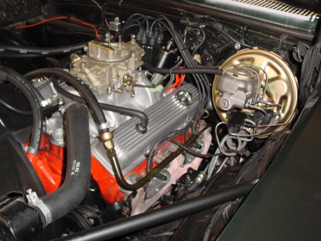

See attached picture, its much easier then trying to describe.

Thanks for the pic Steve!
It's a little tough to tell from the angle of your photo, but that looks like the straight up tower style to me. In one of my "1969 Camaro" Fact books, it shows the tower that leans toward the front of the engine (page 76), and I believe the assembly manual shows one that leans toward the firewall.... Still not sure if any particular style or all three types are considered correct....
I'll use the straight one on my car unless someone has more detailed info as to which one of the three variations would be more correct for my application.
