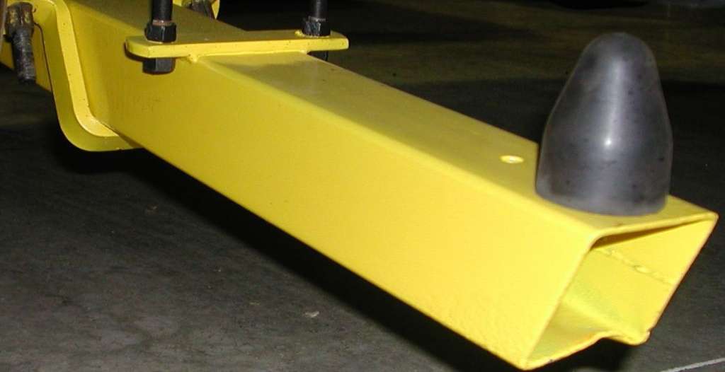

Looking for ideas on how to use the coil spring version on a leaf spring car. Was planning on just fabbing some plates to make it work.... thoughts?
My bars:
Standard instructions:
Out of the box:
Marlin
Old 04-08-2011, 01:57 AM
Location: Pennsylvania
Posts: 9,920
Thanked 239 Times in 197 Posts
Default Re: Leaf Springs with Ladder Bars
Again, what is wrong with vintage slapper bars? That, as you know would be correct! There are some Hurst adjustable drag shocks on Ebay for sale for novas. A tough item.
