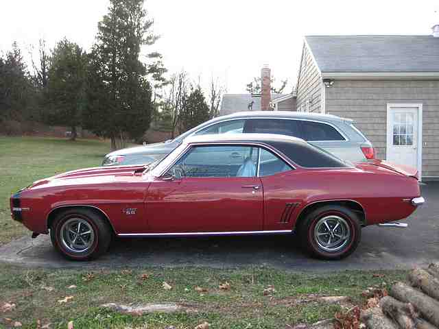

Karen likes Garnet Red
02 Berger 380hp #95
Lots of L78 Novas
Join National Nostalgic Nova!
70 Orange Cooler
69 Camaro

That Camaro is cool...It'd make a great Members Ride

OK Bruce...soon as the weather gives us a window...I will get some pics and hook you up.
