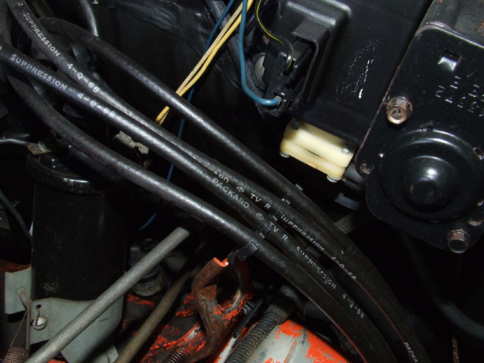

Don't know why it didn't hit me earlier but I realized today (thanks to kwhizz) that I still have the OE wires on my Nova. It's an early January car (12-E) and has 4-Q-68 wires (actually even has a 3-Q on it too).
Here's a shot.
