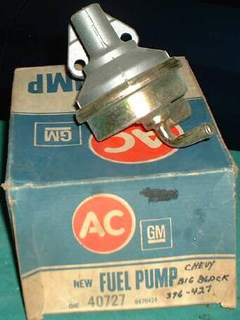

Here is a pump someone was selling on ebay awhile back.
