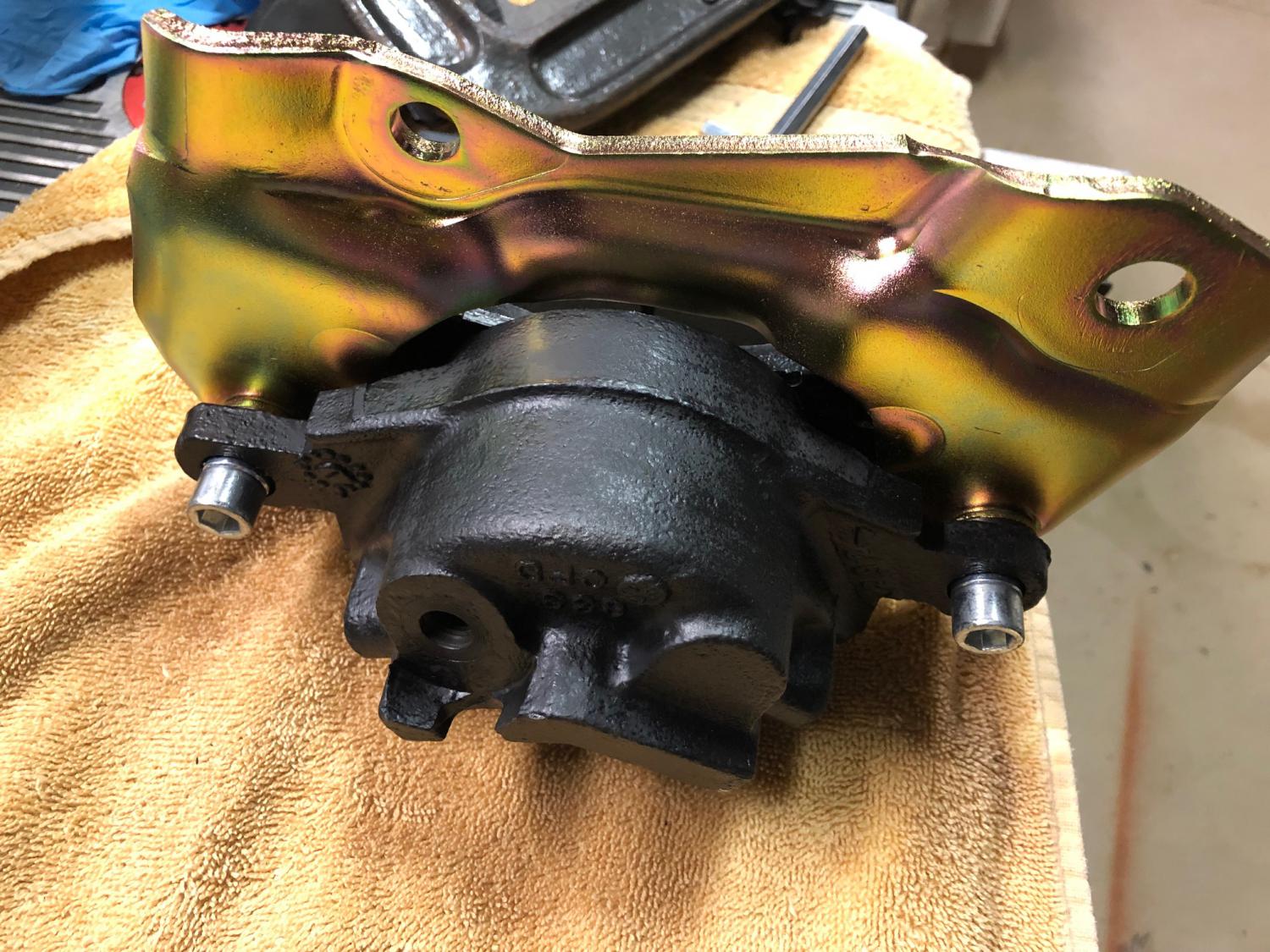

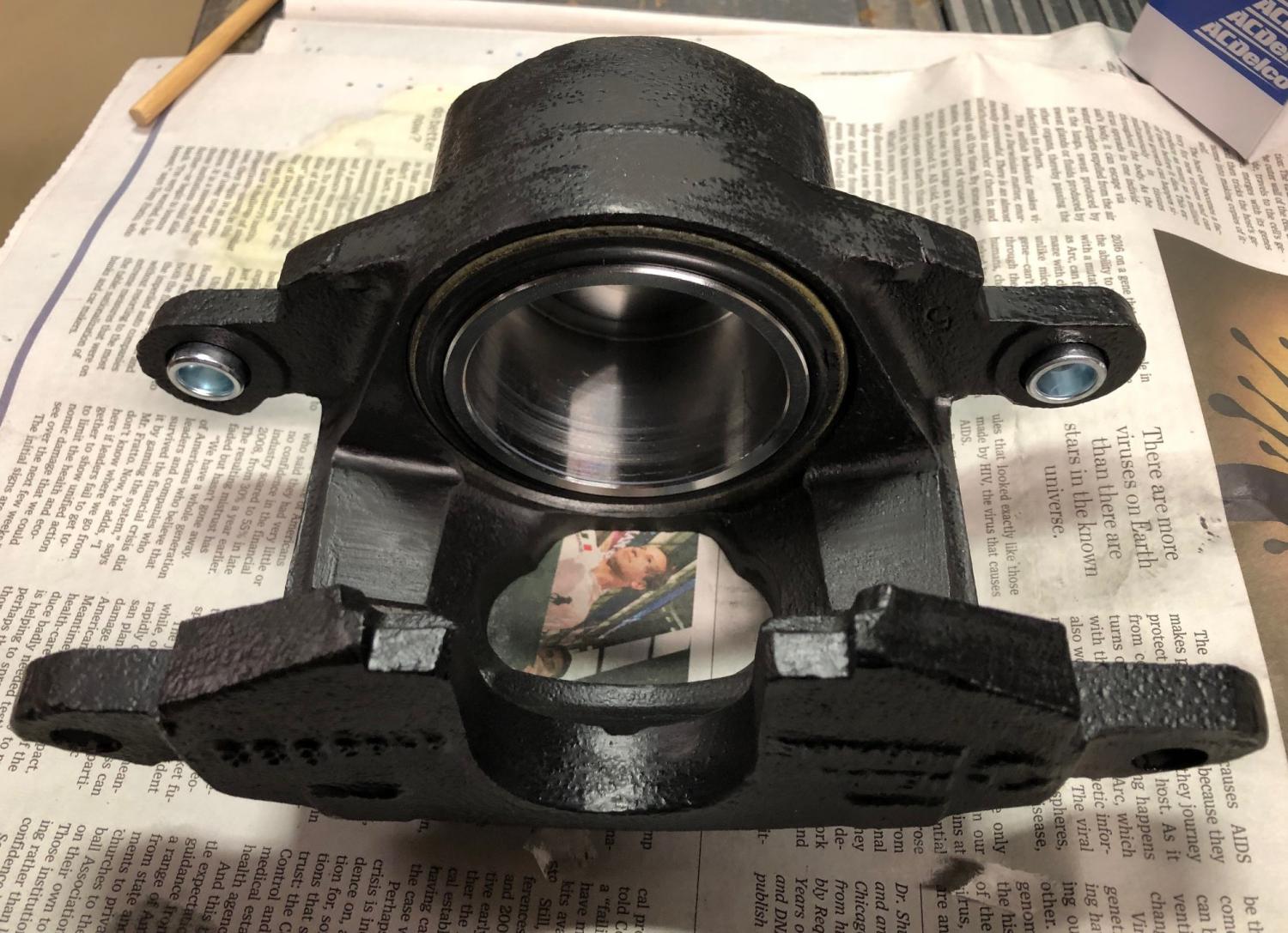

I have been working on restoring my original brake system components and am at the front calipers now. I have restored/rebuilt one and was testing the caliper slide pins (pad retaining rod) and found an issue.

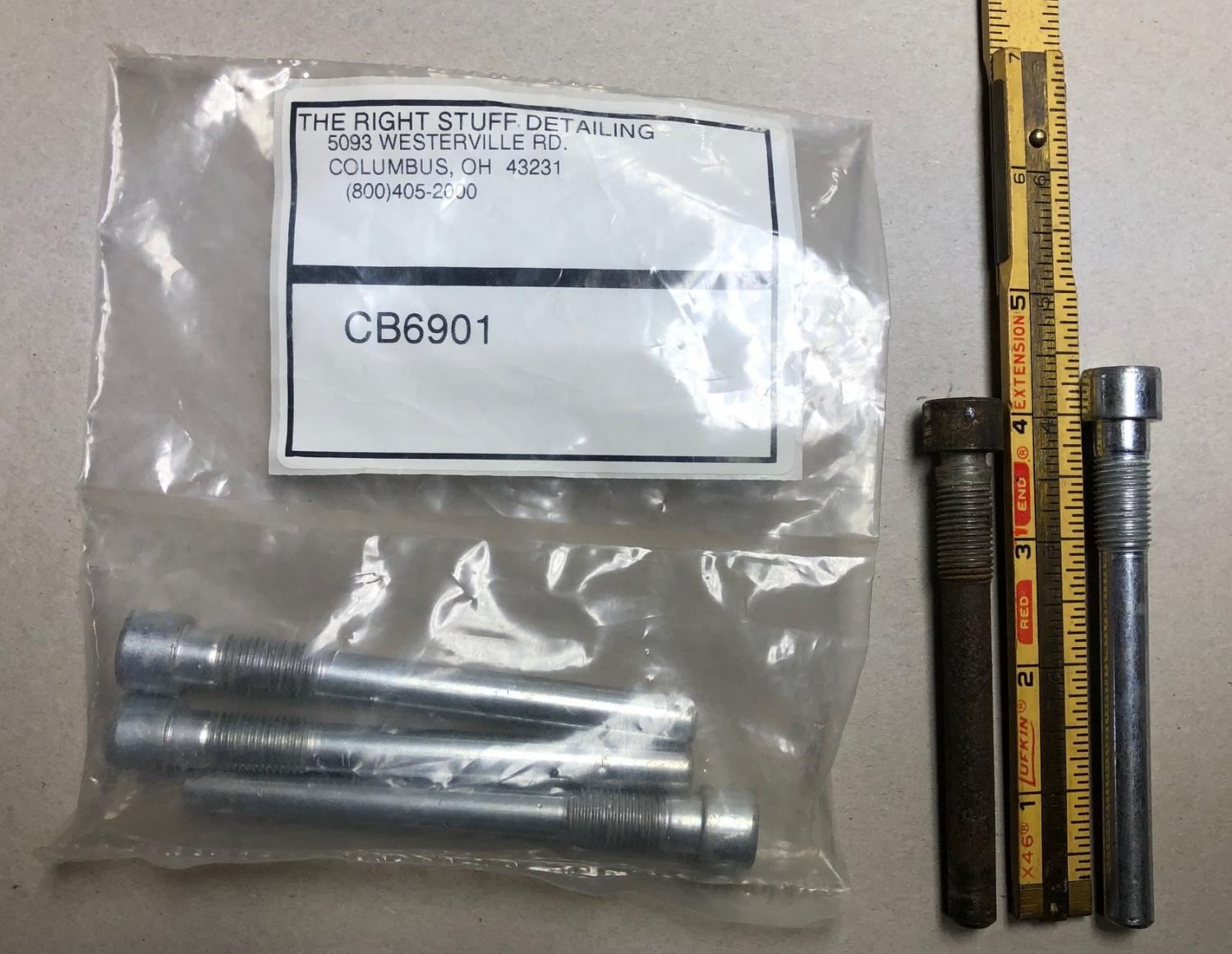

I replaced the little O-rings and the pin does not go through the outside O-ring. I purchased Right stuff pins CB6901 a long time ago and thought these were not the correct part.
I looked it up on Right stuff website: https://rpui.com/-Repair-Parts-1969-...in-Each-CB6901 and sure enough this part is only listed for GM-A body cars. And web page says it does not fit a 1969 Camaro.
So I pulled out one of my originals and though they are the same diameter, the length and thread area is a little different. Original is 4 1/8" long, while new pin is 4 3/8" long.
So then I looked at Heartbeat and their pin (rod) looks the same as the Right Stuff pin, but the description says it fits all GM single bore calipers including 69 Camaros: https://www.heartbeatcitycamaro.com/...Rod-Bolt-Each/
When I do a Google image search all the pins I see are this longer style and most say it fits all the GM models.
So will this longer pin work properly in 69 Camaros?
Or is there a more accurate pin that matches the 69 version?
And how free are the calipers supposed to slide on the pins? I think I need to grease them.
I have found only 3 original pins, so I have to dig more and see if I can find more and see if any are restorable. thx

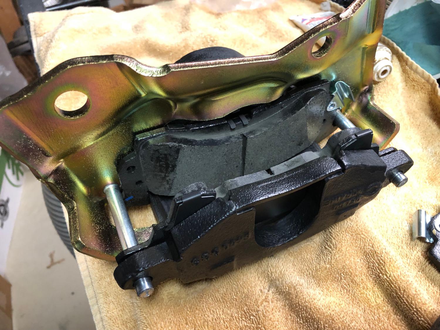

After thinking about it, I realized I needed grease (actually shop manual says silicone spray)
So I got out the parts and did a trial assembly and worked the pins in. After a couple presses and the silicone spray they are much freer now.
My original pins are "S" and the repro ones are "L" both stamped on the small end.
Here is the assembly, seems to all fit fine. Yes, the repro bolts are a bit longer than originals, but since mine will be driven I can use these.
