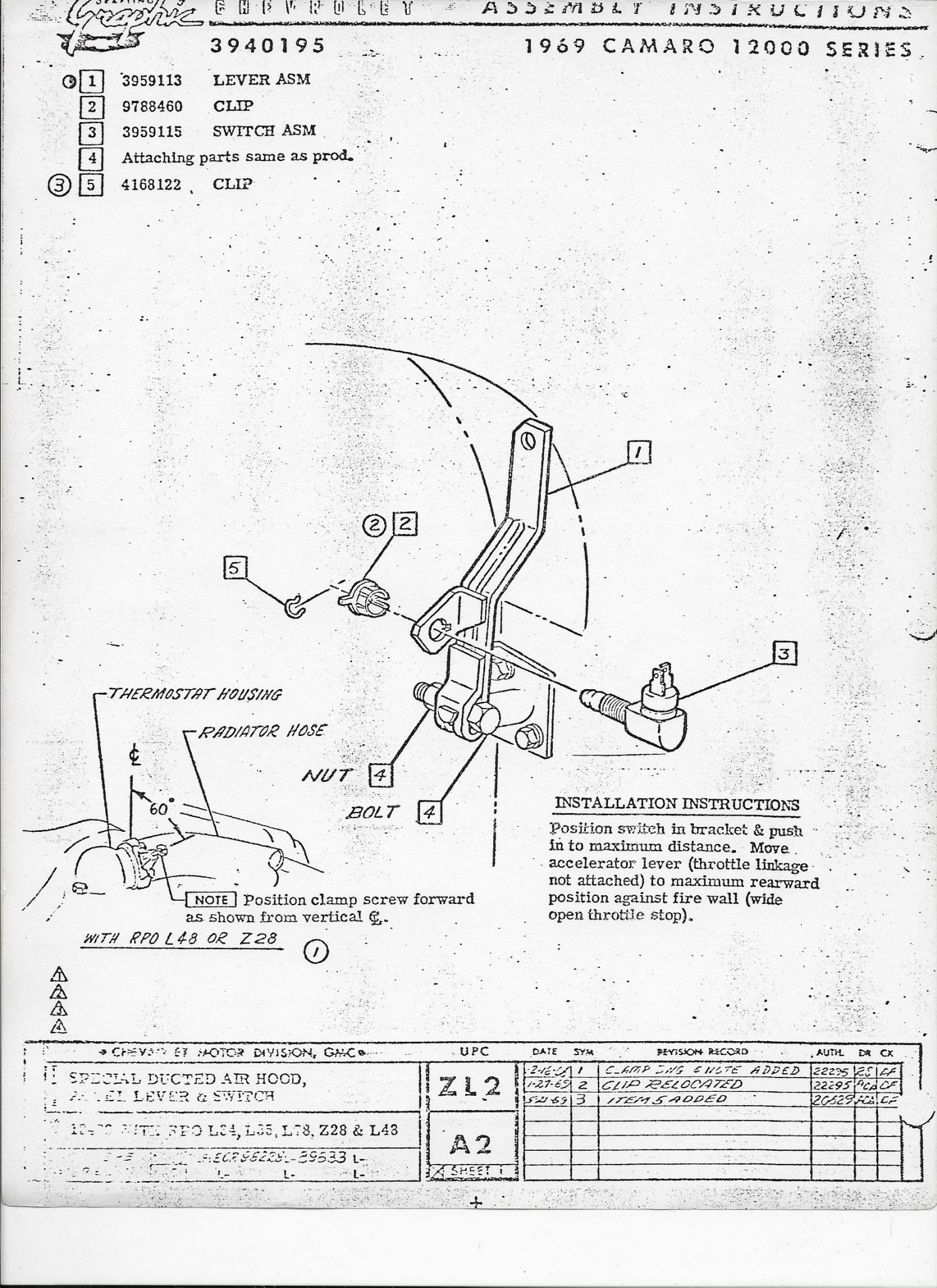

I am trying to figure out how they got this throttle switch and retainer in the hole on the throttle arm.
Fricken broke my first NOS switch trying, now on to the next switch.
Is there some trick I dont know about?
Do you put the retainer on the throttle switch and then put it in the hole?
OR do you put the insert on the hole and try to jam the throttle switch in there.
This is tough I tell ya!!!
Attachments - The Supercar Registry zl2.jpg Scan_20201202 (2).jpg IMG_0153.jpg DSCF7510.jpg

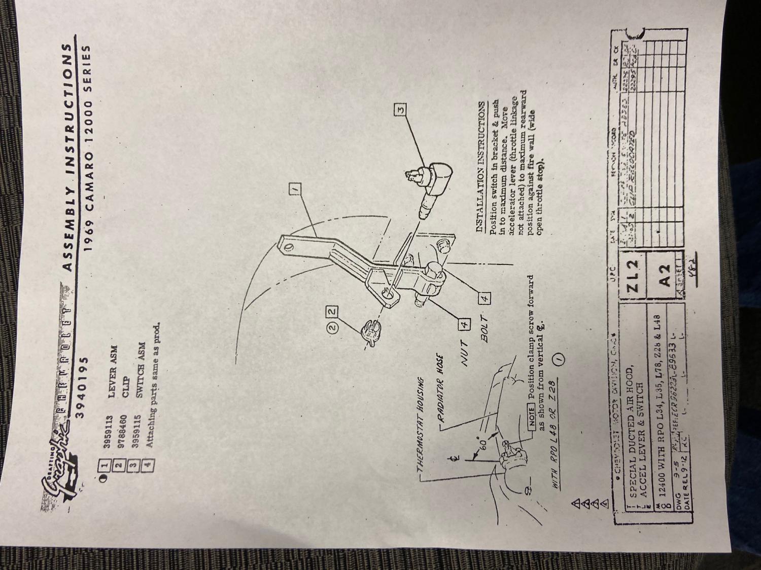

Do the instructions in AIM help? They're on ZL2 A2. I'll send you a picture when I get to the shop....Joe

Joe, thanks for the pics you sent and your willingness to help out

Be sure after you install switch, you install the clip to hold the switch in its adjusted place when you go full throttle. The clip I am talking about is the same one used to hold the window cranks in place. If you do not install this clip after you get proper adjustment, when you go full throttle you will push the entire switch back towards the engine.
