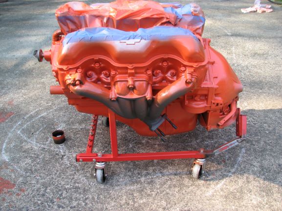

I have always had a disagreement with car show judges on them incorrectly judging restored cars. I had this very discussion with one years ago and I said that he should be deducting points for the guys who have their engines too detailed. I guess this picture proves the painting process of the engine itself. (looking at the big block in the subframe next in line). I know that a few do this now. not nearly as pretty as natural exhaust manifolds.

I almost did, but I didn't leave the block bare behind the manifolds. Two step painting. I couldn't bring myself to be THAT correct.

I modified an engine cradle so the bell could be attached during painting as it was done at Tonawanda.

Right, wrong or otherwise, I restore mine the way they were painted originally unless the customer says no. Concours is concours. I do not paint my manifolds entirely but rather I paint them to simulate what they would look like after much of the paint has burned off.
