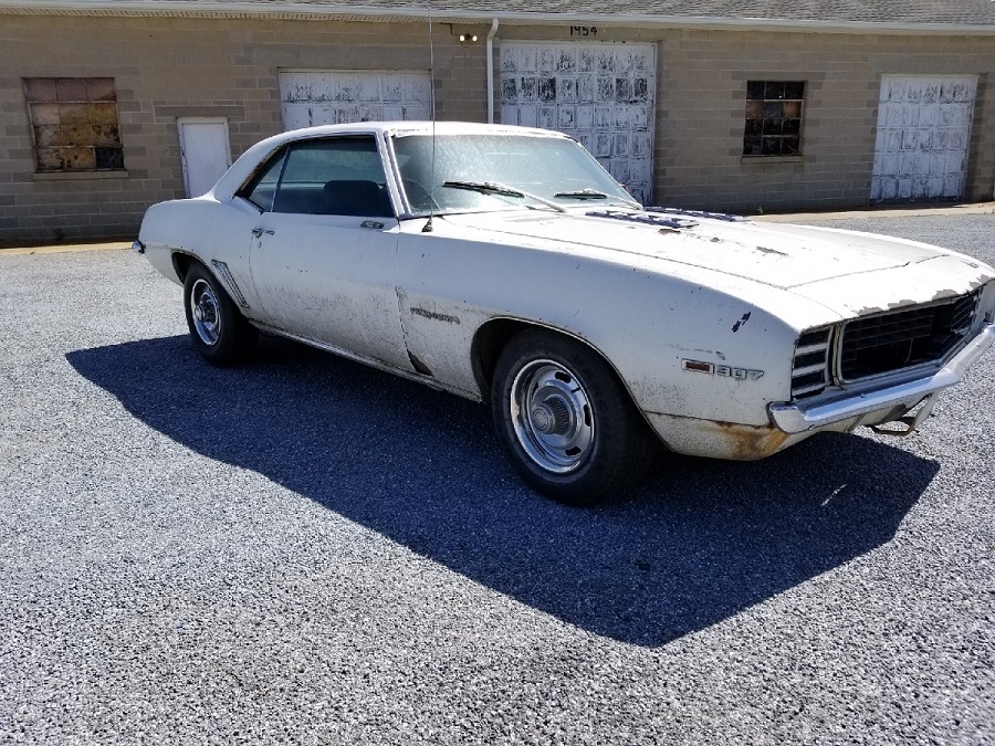

Question for the group. My 69 RS Camaro is currently 100% stock, largely original with about 60k on it. It is not an ultra rare car, other than being unmolested. It has had a poor repaint in original color, some 80’s style rust repair in the wheel houses so she is not a vestal virgin “survivor” but has not been stripped and put back together with wood screws either.
My plan is to make Casper, yes cars name, roadworthy, fully functional and safe. The safe is the question.

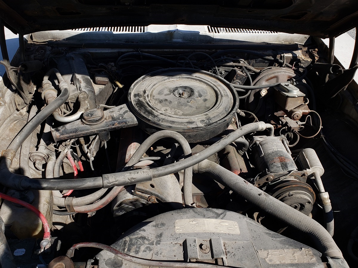

Yes a bath is needed in the pictures but that was as found from 30 years in a garage.

Cool Camaro. Do you have any current pics of it cleaned up?

we are still in cleaning process....yes molasses does move faster than me!
