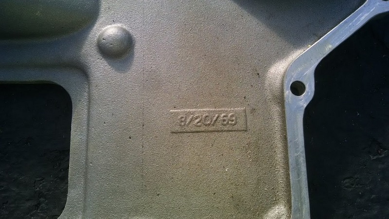

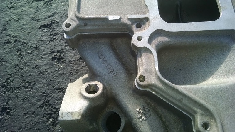

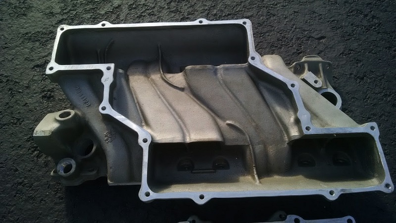

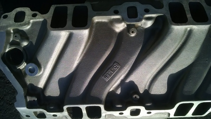

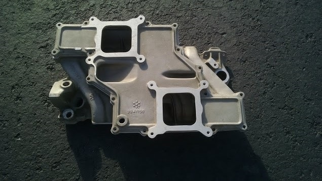

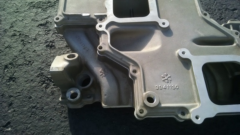

Reproduction 1969 Camaro Cross Ram ( Cross-Ram ) Intake Manifold. Cast numbers 3941130 ( Dated 10/1/69 ) and 3941126 ( Dated 8/20/69 ) All the bolt threads have been professionally chased out. Includes the metal gasket between the two halves. There was some professional machine work done to the top of the thermostat fixture and in front of the first carburetor mounting. Nicely done, don't know the purpose behind the work. Price is pending TBD 585-329-4655
Brad will provide a pricing update based on the new information shortly.

Yes...sure do Jason.
Brad, sorry to inform you but that would be a genuine original "reproduction" intake. Base is not original, nor is the top.
