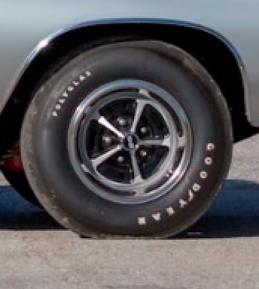

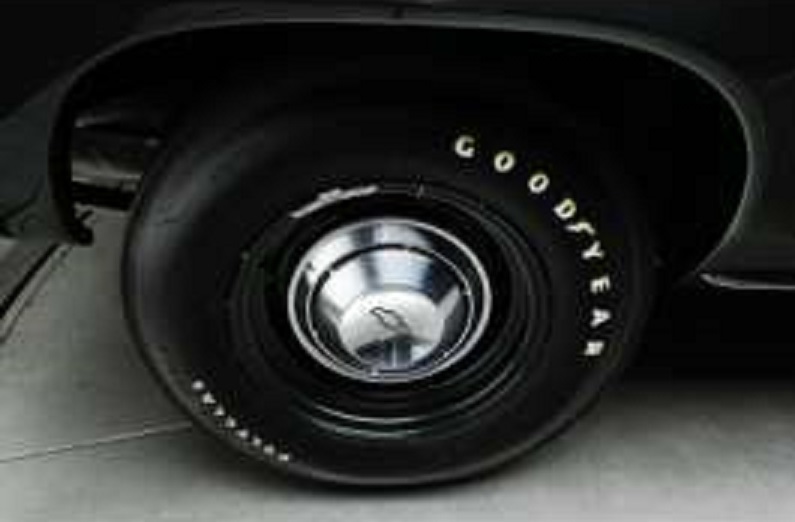

Changing these tires out on a customers 1970 Chevelle SS, which the last owner ordered the incorrect tires.
Wondering what the correct application (Cars) wore these Goodyear Polyglas 14 x 7 F70-14 Tires without the call out of the size.
Found A photo of what looks to be a 69 Camaro?
But Obviously not correct for 70 Chevelle SS.
Let me know your thoughts & Thanks in Advance.
I'll be taking these off soon but want to know for sure the application before I sell in the Classifieds here. Tires have less then 100 miles on them.
*Kelsey Only states these are for 1967 to October 1969*
Last photo is from the Kelsey Web Site.

How about a 1969 Nova? Did they have these?
Old 03-20-2018, 01:17 PM
Location: Woodland, ca. US
Posts: 16,042
Thanks: 527
Thanked 4,964 Times in 1,262 Posts
Originally Posted by XXXBlackLs6M22 View Post
Awesome work guys,
No. Chevrolet didn't use Polyglas in 69. There is a memo mentioning them later in the year and someone claims to have a orig. spare but overall the answer is no.
Old 03-20-2018, 04:22 PM
WILMASBOYL78's Avatar
Location: new york
Posts: 8,376
Thanked 2,213 Times in 592 Posts
Post 69 Nova...
As mentioned...there were no raised white letter tire options for the 69 Nova. The Nova SS came std. with E-70 x 14 red-line wide-ovals...white-lines were optional.
