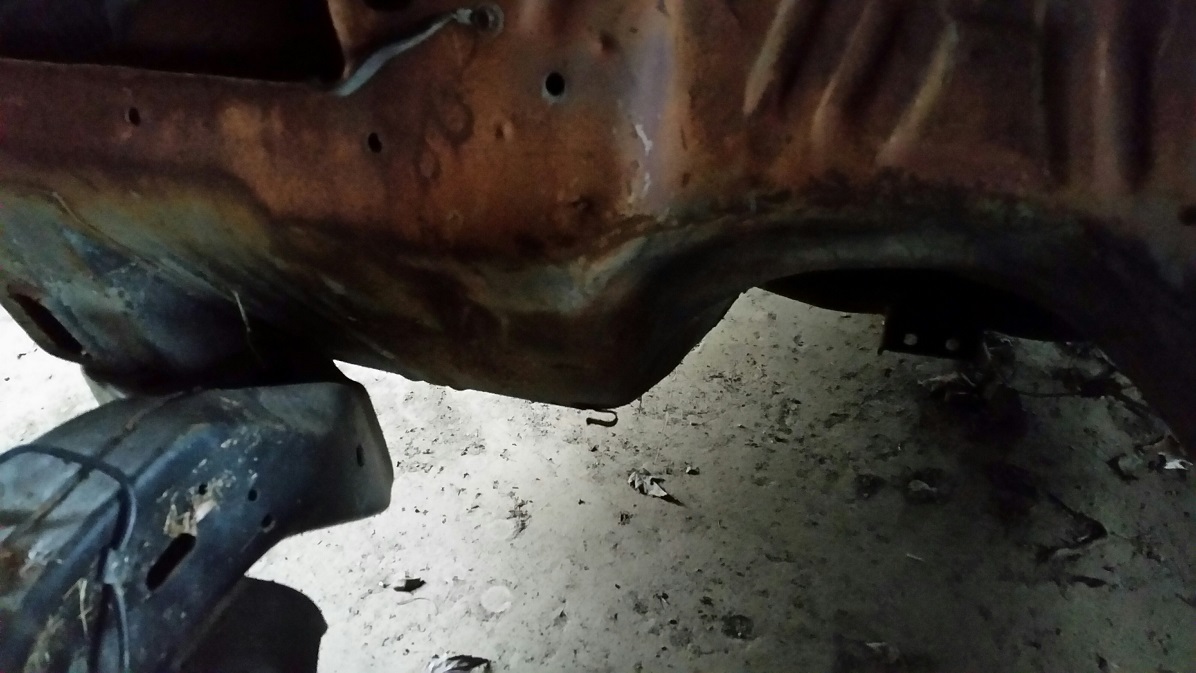

The L79 had a 12 bolt rear end. On the floor pan there is a clip for the speedo cable if its on the passenger side and a hole in the firewall on same side it had a muncie trans, if the clip is on drivers side it was a Saginaw. The L79 had muncie trany.

Ok, looks like it was a Muncie. Am I right? Are there any other clues to look for?

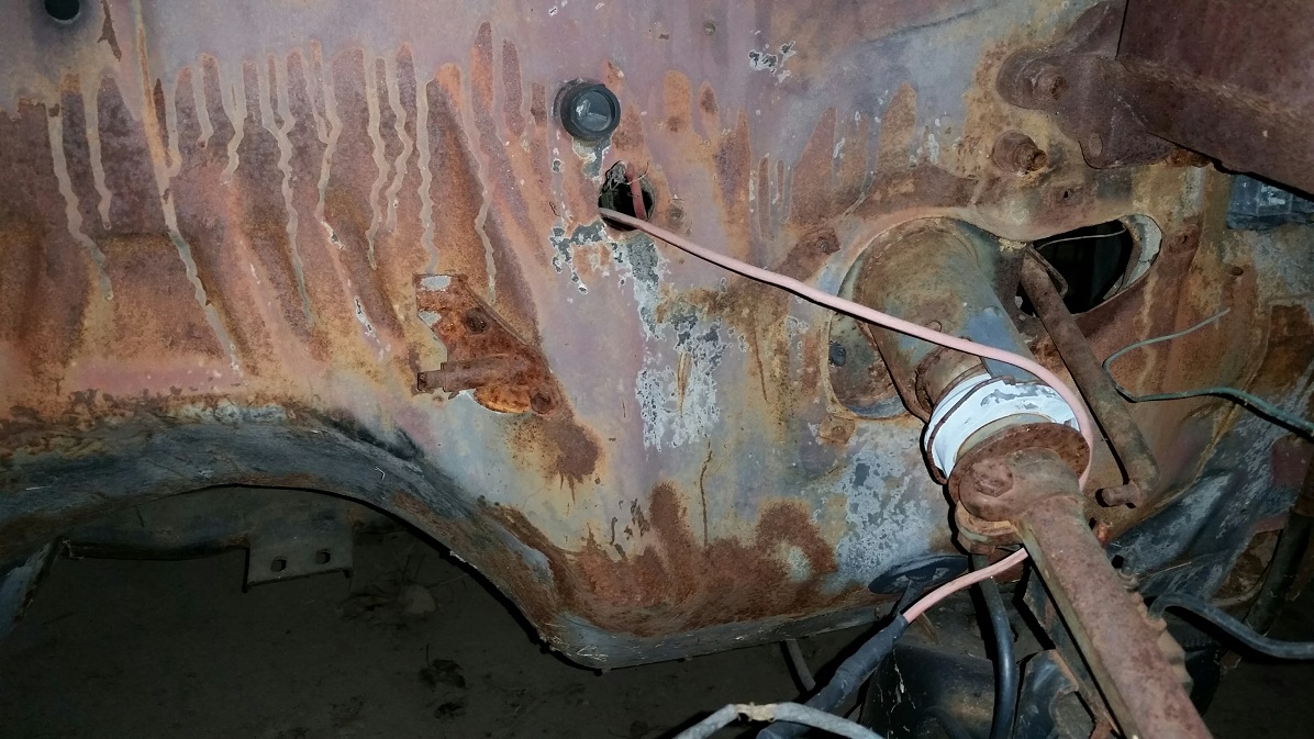

Bob and DWR have offered acurate and useful clues. Looking at the firewall pix, I see the pass. side cable clip, but no speedo cable hole. On the driver's side I see a cable through what appears to be an original cable grommet, indicating either a Saginaw 4 speed or T16 H/D 3 speed (assuming it is a floor shifted manual trans car).
Having a cable clip on the incorrect side is not unheardof.
My thought is that IF it were an L79 it would have had the H/D three speed, but much more likely to be an L30 Saginaw 4 speed car.
All considered I would say this is not likely an L79 car, and even if it were without docs or any of the original drivetrain there wouldn't be any significant value added. Go ahead and build your race car!

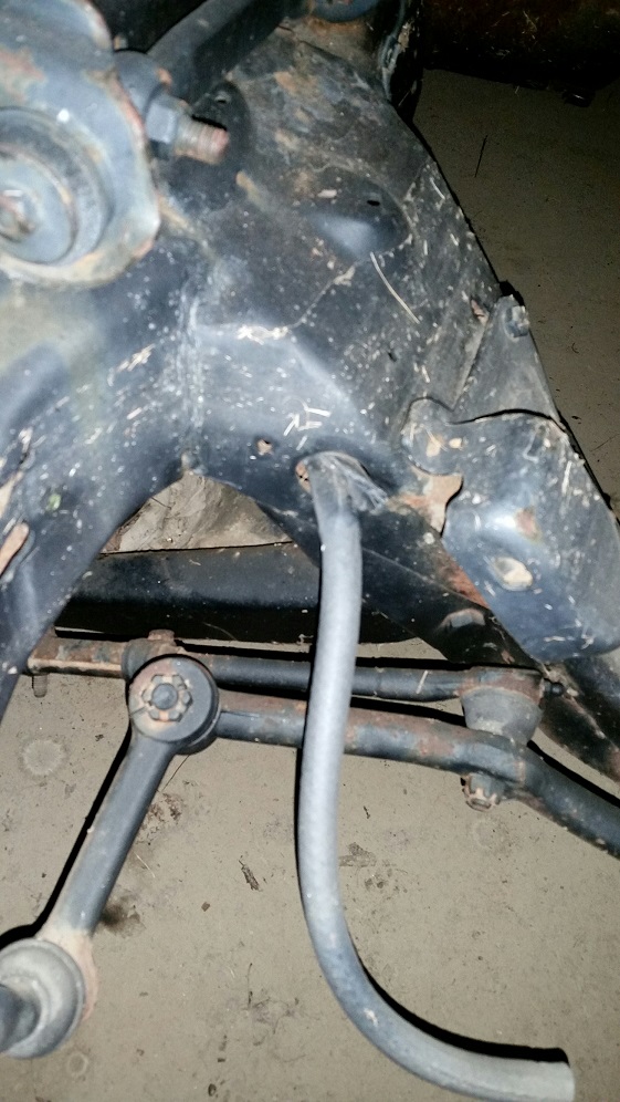

I had a chance to check the fuel line on this car yesterday and this is what I found. Looks like a single 3/8 line.
Freddie
