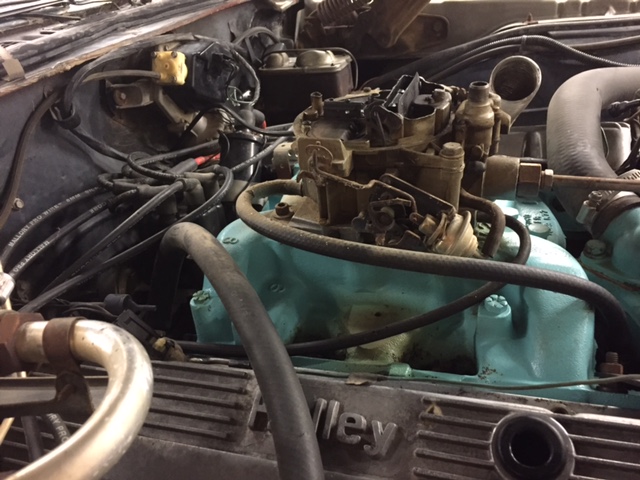

Here is a pic

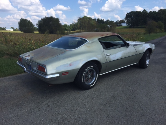

Talk about patina

Right off the bat I see you are missing the choke pulldown thermostat spring assembly. nd of course 1972 used its own one-year-only unit for that application. Get me more photos of the entire top of the engine so I can make a list for you.
