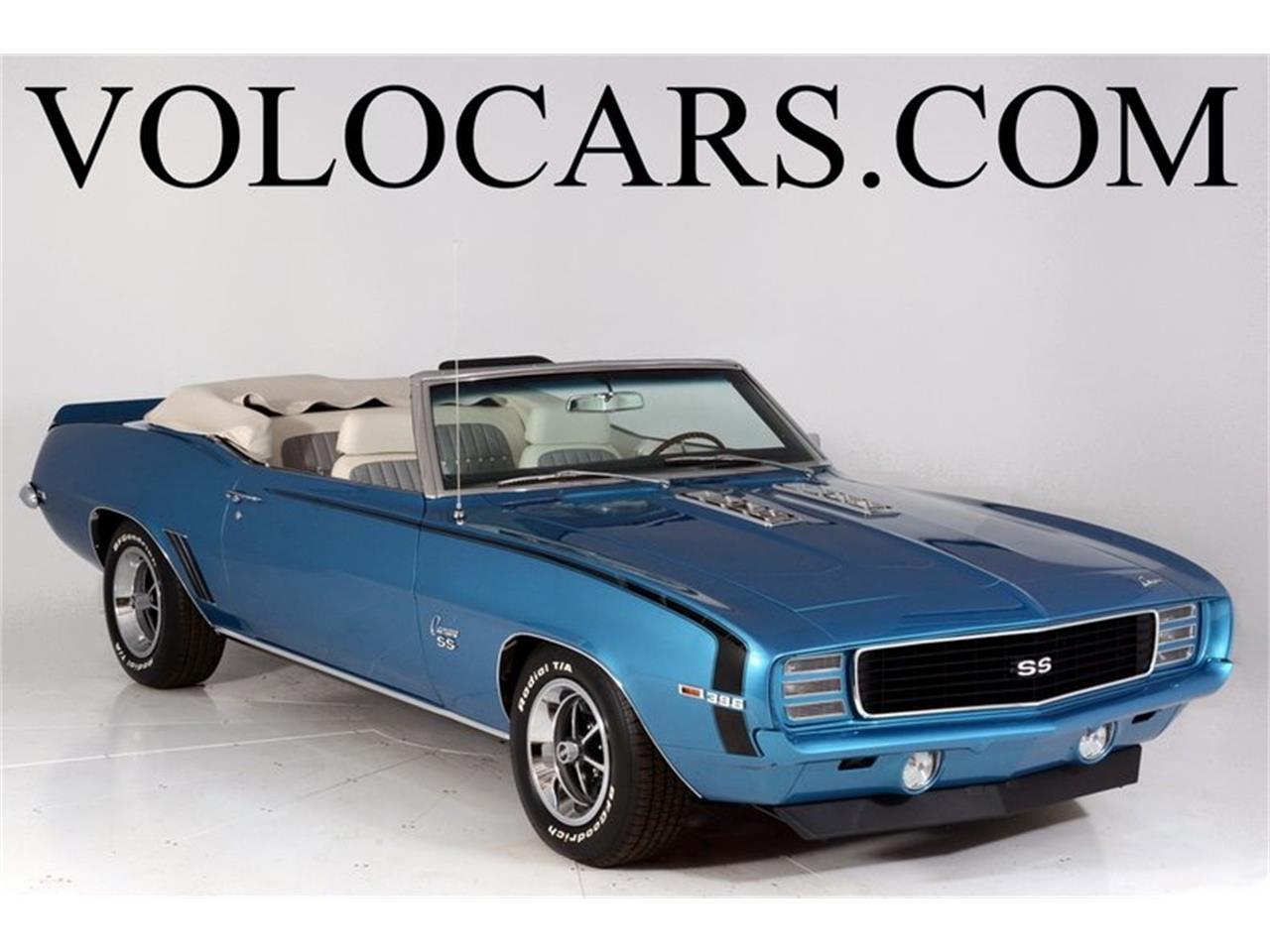

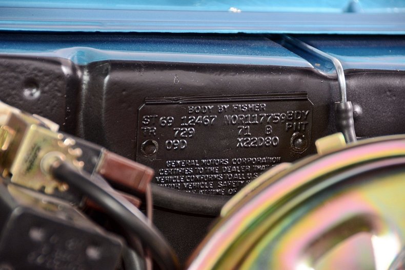

I am not liking that trim tag at all. And, as Scott mentioned, houndstooth wasn't even available in verts other than pace cars.

Very late car; shouldn't an L-78 have an 8000 tach?
Front subframe horribly dented, which is common, but should be corrected on a high dollar car.
Deep rust pits on the firewall were just painted over.
CAUTION fan sticker?????

I'd be very skeptical...could not get convertible in the houndstooth interior except the orange houndstooth in the Pace Cars...."window sticker" states white houndstooth interior...no pic of trim tag...I'd say it was recently built to be pretty.

Tag:

Repop tag. Lynn you forgot the cheap ass chi neeze booster.... [img]<<GRAEMLIN_URL>>/sick.gif[/img]

That's a terrible repo tag..
