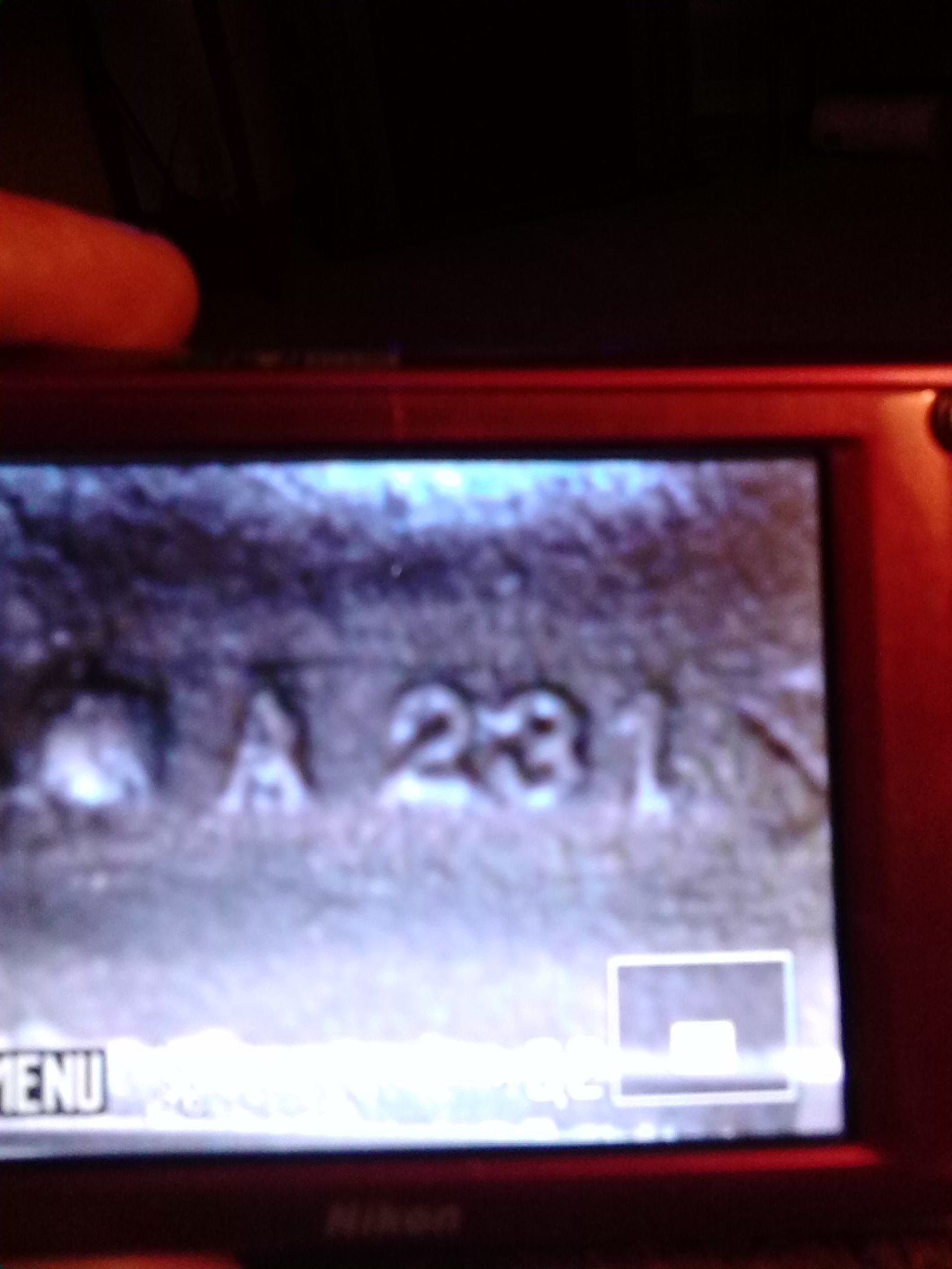

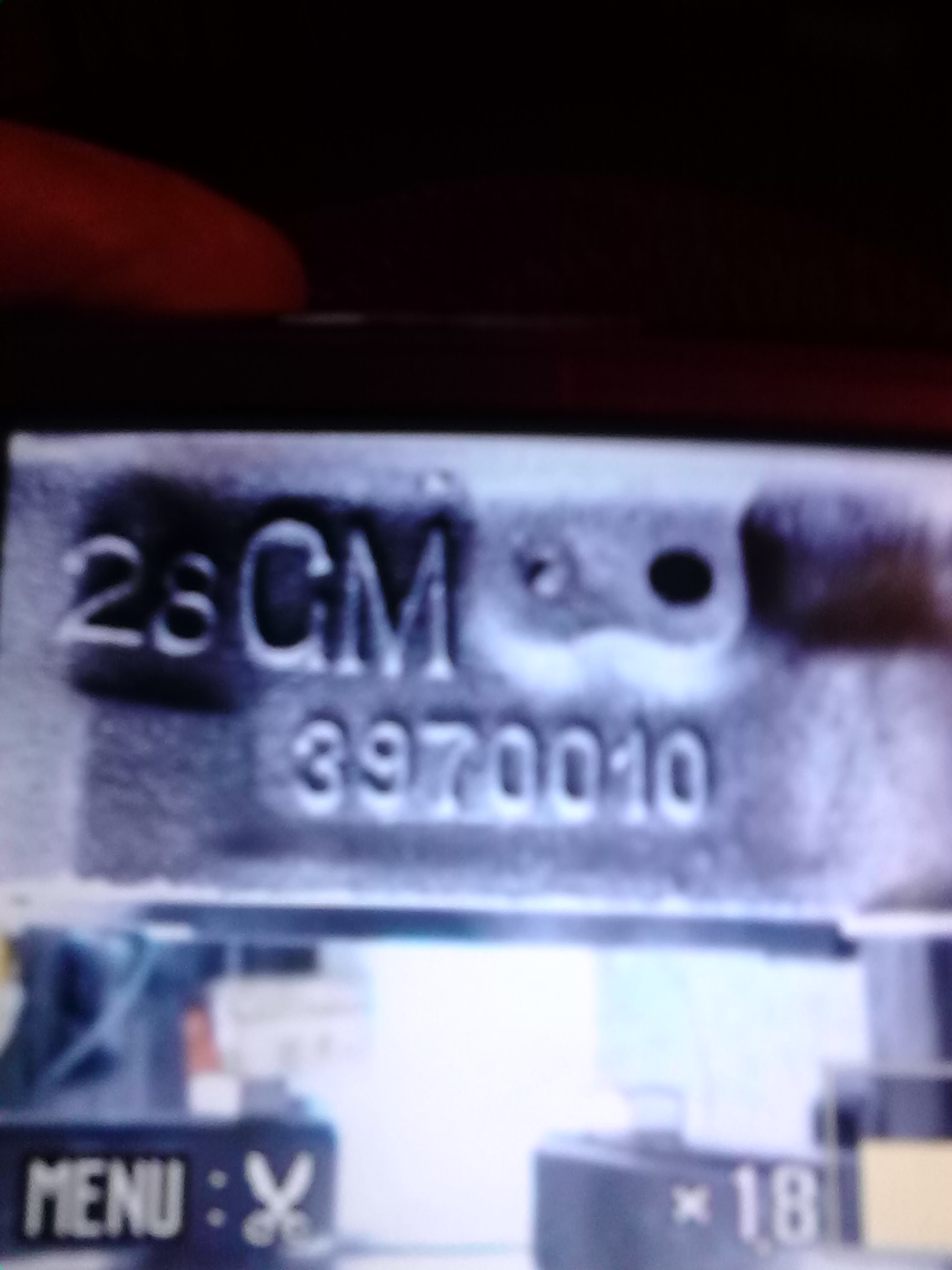

Can some one decode this stamping on the deck off a nov 1969 512 cast. short block ce078219.thanks marc.

Chevrolet Engine# 078219.

I believe the '0' refers to a 1970 build.

CE Chevrolet Engine
0 2 7819
1970 Feb. Sequence
As sequence ends it starts again as
CEA yr.mo. 0001
Have seen CEB & CEC Stampings.
A Misuse of terms is CE "BLOCK"
AS MOST CE's Were Engine assemblies known as. Partial Assembly "Short Blocks"
or Engine Assembly "Long Block"
Catalog items.
Bare Block w Caps
Fitted Block (Partial) (Fitted Pistons)
Partial Engine Assembly. Block & Rotating assem.
Engine Assembly "Long block assm."
Most All L88 CE 's seen today were Complete engines - bolt-ons
Most LS 7's were also sold as Complete Engine.
