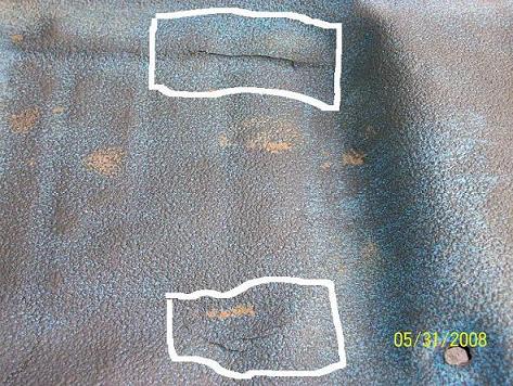

I was wondering if anyone has every fixed small tears/cracks in these rubber floor mats. The type I am talking about is for the bone stock, no frills, Nova's. I just removed a mat from one today and was wondering if it was junk or if it is restoreable? Any help is always appreciated.
Jed
Attachments - The Supercar Registry 342178-Silverbullet011.jpg 342177-Silverbullet015.jpg 342176-moregashes.JPG 342175-gashes.JPG

It seem that I remember somebody using a tire tube repair kit to fix a tear in one of these mats.

I will have to post some pictures of the mat. And some of you guys can let me know if it's too bad to restore. But, I will try the "tire patch". It can't hurt! Thanks Mark.

I'm thinking that rubber bumper (endura) repair stuff would be good for this. That's the 2-part epoxy-like material you use to repair/fill holes in GTO-type bumpers. It worked great fixing my rubber coated Trans Am steering wheel.

If I am not mistaken Frank has gone through the steps to repair holes as well as tears. From what I remember he would put a patch on the backside and then splice in on the front.

I've used the rubber tube repair kit with moderate success. I believe there is a better solution now-a-days, TomK can relay...

Sorry guys, I have been between homes right now. Watching dad's place while he is away in Canada fishing, but I do have them on a camera and as soon as I have some time, I will download some pics and post them.

You might want to try Loctite 495 super bonder part #49550.
It will stick just about anything to anything....including your fingers. It is clear so a repair shouldn't be very obvious. I keep a small bottle of it in the refrigerator. Stores best when kept cool.
