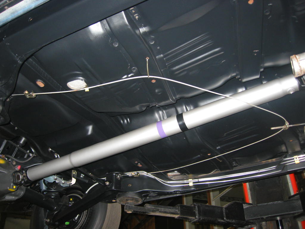

A friend is completing the resto on his 1970 GTO 400/ram air 4 car with a 4 speed.. He needs to know what color stripes go on the driveshaft for this car and where the placement would be...
Thanks.... Rich

1 Purple and 1 black about an inch wide and 3 inchs apart about 1 quarter back starting at the front. Hope this helps

Thanks Don, I'll pass the info and picture on to him...
Rich
