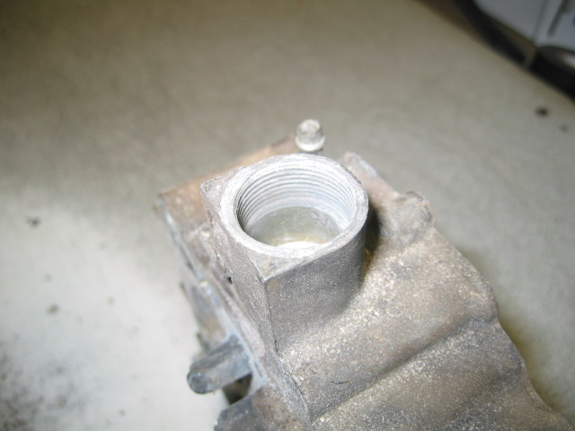

Next on the list is the venerable Quadrajet.
QJets don't usually suffer the same indignities as Holleys do, but there are a few key things to look for.
In no particular order...
Over-tightened castings: Look at the front mounting bosses on the carb--are they deeply gouged and scarred? If so, someone has over-tightened the carb at some point, and you can just about bet that the carb is warped.
Sometimes they can still be used if they're only slightly warped, but if they're too badly warped, they'll never seal up and aren't safe to use.
Here's another way to spot a warped carb; Look at it dead-on from the front and see if you notice a "crown" in the middle of the casting between the main body and top casting.
This one looks good.
Last thing regarding QJets for now. One common malady is leaking well plugs. Symptoms of this are difficulty starting the car after it's sat for any length of time, or emitting a cloud of black smoke on warm re-starts after the car has sat for a little while. This is caused by gas weeping past these plugs and draining into the intake manifold. Left long enough, the float bowl can drain completely, hence the hard start after sitting for any length of time.
Two of the well plugs can be seen in the recessed cavity above the throttle blades in the picture below:
(There are a few more well plugs hidden underneath the baseplate that can't be seen.)
Most any rebuilder will cover these well plugs with heavy duty epoxy during a rebuild, which will eliminate the issues mentioned above.
