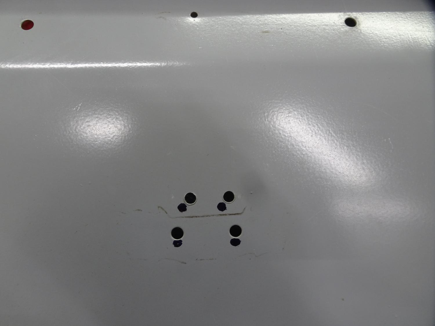

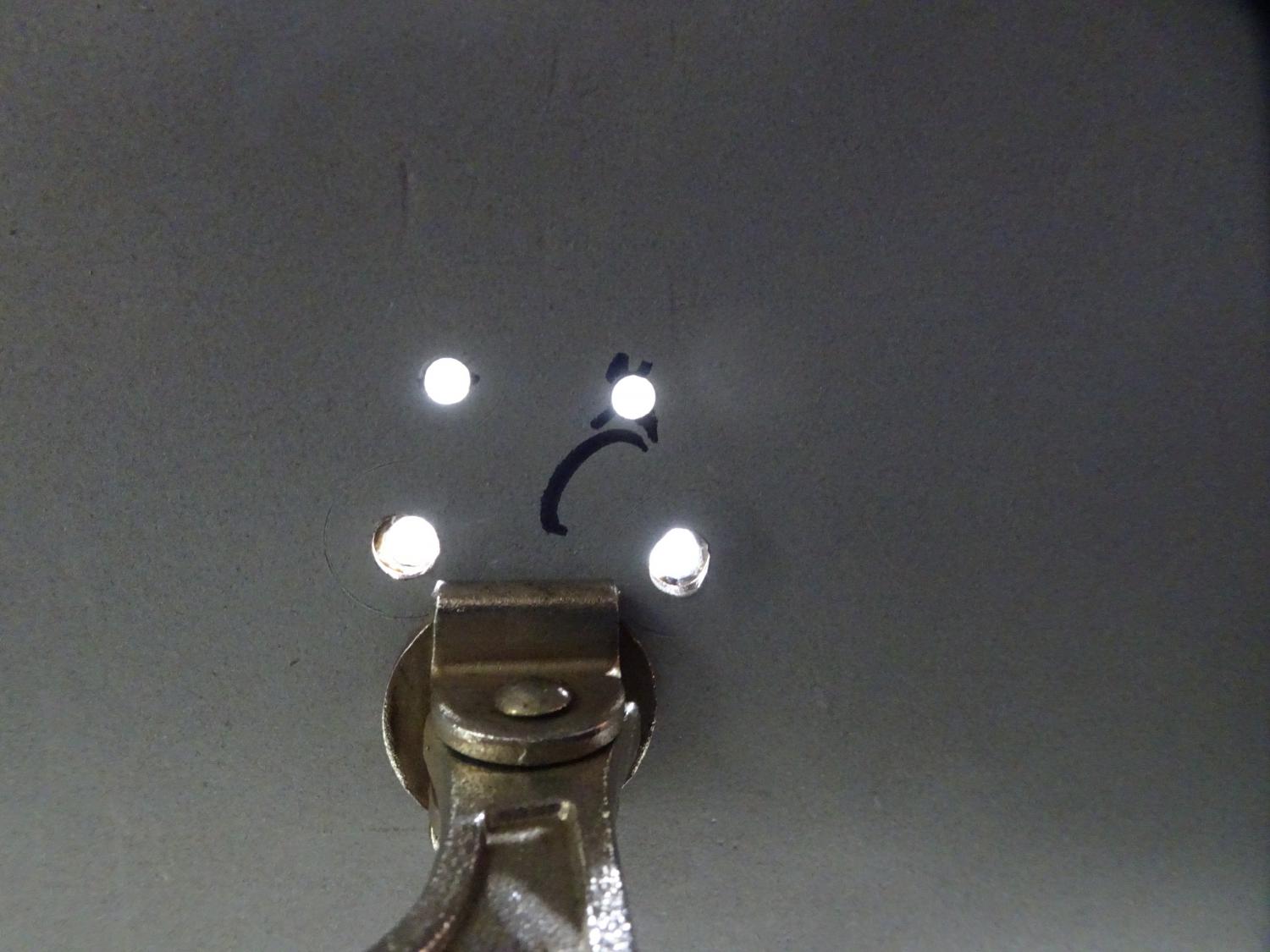

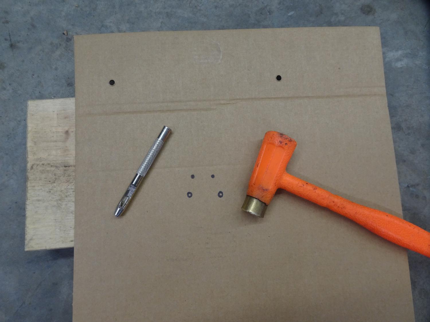

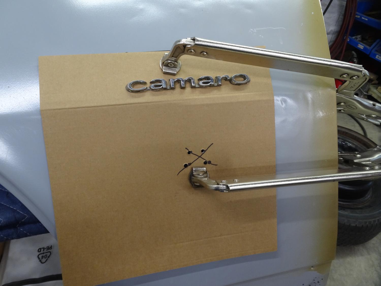

I made a template of the 350 and V8 flag from the left fender. Flipping it over it SHOULD have produced the same location on the left as a mirror image. The 350 and flag emblems are about 3/8" lower on the right fender. They both appear to be GM and possibly factory installed. The rs trim holes are punched, as original, not drilled as most replacements.
Anyone with an original '67 SS 350 car that could measure from the bottom of the camaro emblem to the top of the 5 in 350 and the crossbar in the V for me ? The m lines up great with both.
