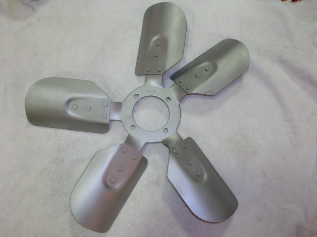

Anyone have a picture of the correct 5 blade 4 rivet fan blade that was factory on a 68 Z

Here you go.

Thanks that is the one that was in the trunk of my z when I bought the car and the engine had a flex fan on it. Nice to know I have the correct one.

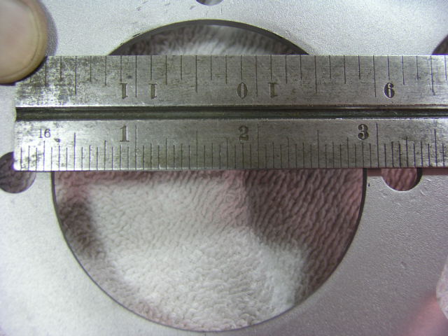

Check the hole diameter to make sure it is 2 5/8 inches. There is another fan that looks identical to this in 68 also a 4 rivit but has a smaller hole diameter and not correct for the Z.

I will measure it when I get home,never knew that.

size...3 1/4" bolt spacing
