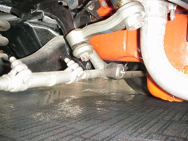

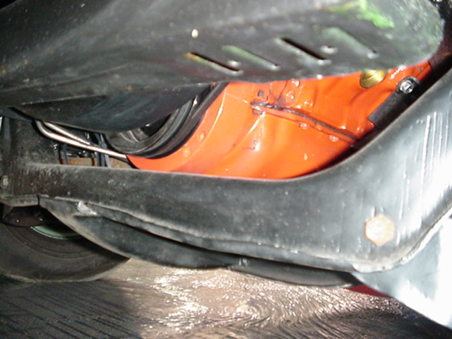

The Gibb novas had a replacement oil pans put on them under warranty. That is the same pan. A lot of the cars blew up in the first 90 days. My green car had the pan replaced on it. The cars must been recalled to have this done.
