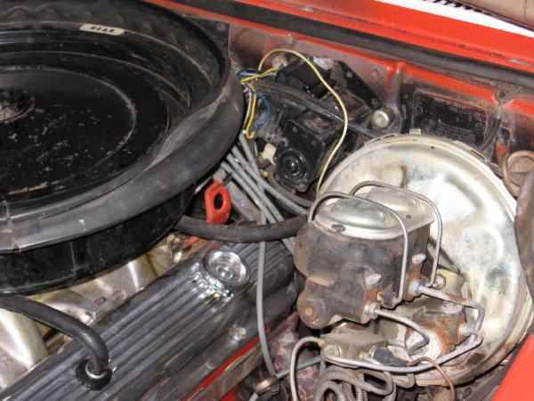

Is the power brake metering valve on a 1969 COPO camaro supposed to be located below the power brake booster, next to the distribution block (same configuration as my 1967 Z28) or on the sub-frame in the rear brake line? The assembly manual is nt real clear on this and I understand that the Z28, SS and COPOs had the block located differently than the regular power brake cars.

The round metering valve is attached to a small bracket that attaches to the outside stud the master attaches to. The valve is located to the left (drivers left)of the distribution block , and slightly up from the block. I think a picture would explain it much better. I will look for a pic later.

Attached is a pic of the metering valve location. This pic is from a survivor Z we will be certifying thru Vintage Camaro at the Camaro Nationals @ Carlisle this year.
