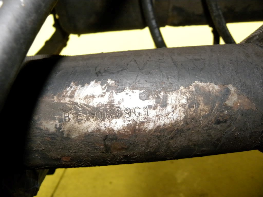

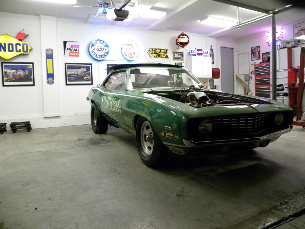

Got a customer that swears he has a copo car, no motor or trans. 02A built car, x11, 6912437NOR252921 on tag vin 9n593??? Yes, no, maybe?

the rear axle code will tell if it is original COPO or not
bb heater core?
tire size sticker?

A BE axle means nothing. I have had several and decent fakes have been made out of BL axles.
There are no known COPOs near that VIN. The first grouping of Yenkos were N578xxx-N579xxx. The next batch [a few Yenkos, Bergers, Emmert] were N608xxx-N610xxx.
There are several very well-done COPO clones out there. A real one needs bullet-proof paperwork to be accepted as such.

BE rear means nothing? Wow.

<div class="ubbcode-block"><div class="ubbcode-header">Originally Posted By: SuperNovaSS</div><div class="ubbcode-body">BE rear means nothing? Wow.
Jason </div></div>
It means somthing if it's never been screwed with... [img]<<GRAEMLIN_URL>>/dunno.gif[/img]
Jason </div></div>
The presence of a BE axle is hardly a foolproof indication of a COPO. Neither is a curved-neck radiator.

I would think that a BE axle that is untouched and looks to be original in a project car or survivor to be a good tell tale sign.

<div class="ubbcode-block"><div class="ubbcode-header">Originally Posted By: Fast67VelleN2O</div><div class="ubbcode-body">I would think that a BE axle that is untouched and looks to be original in a project car or survivor to be a good tell tale sign. </div></div>
I looked at a BE under those circumstances some time ago; an untouched axle in a project car. It was in a '67 Camaro and had been there for decades.
Both of the loose BE axles I had ended up in COPOs because neither had the original. One is in a Yenko; the other is in ZL-1 #40. I sold it to Lewis Swan when he owned the car in the '80s. I took the axle out of an Olympic Gold Yenko in a junkyard in 1981.
Many COPOs have been destroyed; some existing COPOs do not have their OE rear axle. The axles are out there somewhere.

Yeah, BE codes and curved-necked radiators don't mean anything special at all and should not influence a person's purchase decisions!
