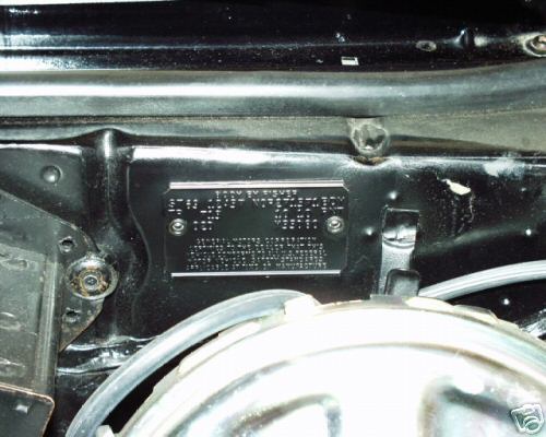

I was looking to get a little help from the pro's. A friend is looking at buying this 1969 RS Z/28 that is 10 10 tuxedo black. It has a 502 in it now but that would get changed out at some point. I'm just curious what you think about the tag. Does it look correct. For some reason it looks to perfect to me. I'm not a pro so let me know what you guys think. Thanks in advance for your help. Jesse

Hard to tell from that picture Jesse. Can you get a closer shot?

That's the best I could get from my friend. I will try and email the guy to get a better shot of it. If I can I will post it later today. Thanks for taking a look Tony. Your help is greatly appreciatted. Jesse

Car was on ebay ... discussed at length on camaros.net.
BOTTOM LINE... FAKE TAG
~JAG~

Thanks a lot. I kind of thought that it was to perfect looking for a 37 year old tag. Thanks again Jesse

Tag is a repro.
