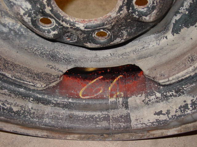

What type of markings would be on a spare tire wheel for a 69 Camaro or Z? Or did it matter?

Every original Camaro or Chevelle that I've seen has the last two digits of the Sequence Number (top left corner of Broadcast Copy) in yellow crayon. See attached.
