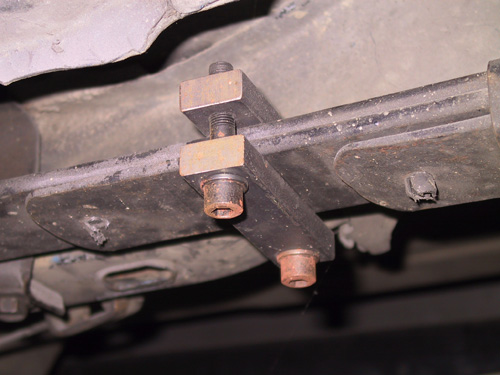

I read a post a while back about clamping a piece of flat stock to the front of the leaf. Anyone use this on thier car? I need to come up with something for wheel hop. So far, the Comp Engineering ones look the best. Any better ideas? Multi leafs on it.

Before going to full blown traction bars I'd give leaf spring clamps a try...unless you're running stickies on the back, the clamps should be just fine...1 clamp per side may get it, but don't be surprised if you end up clamping every leaf on both sides...Mr. Gasket makes 'em, but they're a tad too wide and may rub the frame rail or fender, but they're easy to make, and can be anything from a 2 small flat pieces of steel & couple of bolts or a piece of round stock bent into a "U" with a piece of flat stock on the bottom with a couple of nuts...I've ran both, and they seem to be "ok"...

Definitely use the leaf clamps first, start with one on each side in front of the wheels. Add as necessary. If you buy the Mr.Gasket set, make sure you have a grinding wheel to shorten them - they indeed hit the frame rail upon launch. Also, the Mr.Gasket set has bolts with too long of a shoulder, and therefore you will need to purchase shorter bolts or at least bolts without a shoulder. With this much work it may be better to follow Rob's advice and make a set.
They definitely work, I raised my launch RPM from a 1000rpm idle launch to approx. 2000prm launch with no wheel hop and minimal tire spin.

During the SS&DI magazine test back in 1969, Ed Hedrick used 3 clamps per side on the Yenko Camaro demo car. Car got into the 11's.

Thanks. I will make some clamps this weekend. They look almost too easy to make.

Tony, I can send you a pic of the clamps on my car if you're interested.

Thanks Tony. Yours look almost identical to what I made. You have a PM...Tony
