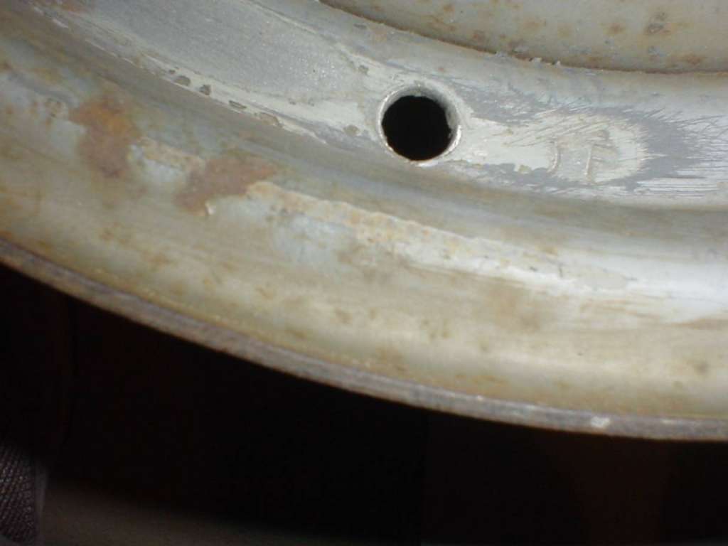

One of the members here is looking to buy a 67 DF Wheel that I have. Can anyone here look at the wheel to see that I have the correct part? The stamp is not all that clear and I don't want to misrepresent this thing. I have had it long enough so that I think it is real....but you never know. The DF characters are the larger font size and there is no date on the front of the wheel that I can find. thanks

If the 1967 DF is like my DG wheels the date code is in side the rim. Not seen once you mount a tire. Roll the rim around until you see a date code and a little symbol.

All the 67 DF wheels I've seen had the 'DF' printed 180 degrees from the wheel you have. You probably have a 68 and there should be a date code either on the spider section or on the rim. See the posting I made some time ago on camaros.net entitled "67 vs 68 DF Wheels".

I will plan to look tonight for a date. I have heard that 67 DF's have the DF upside down. But on this wheel the DF characters are much larger than on my 68 wheels and also there is no date on the other side of the hole for the stem, which I think is only on the 7's?

Inside the wheel i found 15x6JK but no date, and also what looks like a Kelsey Hayes stamp or logo
