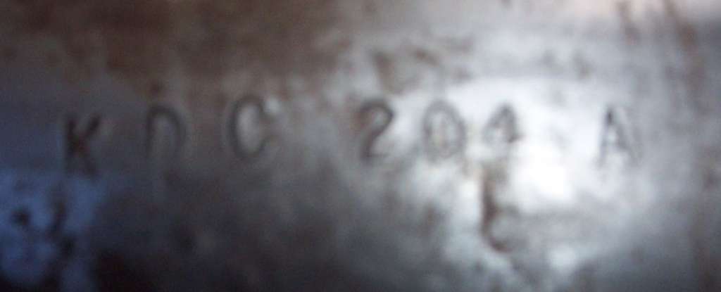

I just picked up a 12 bolt rear. It is a factory 4 link setup. I haven't measured it so I don't know if it is A body or passenger yet. The code is KDC and it is a 1970 casting. Can anyone tell me what this decodes as? I don't see it in any of Colvin's books which leads me to believe it is Olds or Pontiac. Any help is greatly appreciated.

The only thing I could find is that it *might* be a 1971 application for Chevelle/ElCamino.
Does it have the Chevy-style finned rear cover?
Are the axles retained by c-clips or pressed bearings?

It has the standard Chevy cover. Not sure on the axles as the cover is on as are the drums.

It's CKD suffix 2:73 open rearend for a 1970 Chevelle-Elco-Monte.
Starting in 1970,Chevrolet started the three code suffix and some of these were stamped with the "C" on the end,from my findings.

Do you find that the 'C' stamping, whether it's a prefix or a suffix, is stamped separately from the other two letters? It appears that the old two position gang holder was used and the 'C' was stamped separately on the rears that I have seen.

That's what I have seen too.
There were 3 different plants assembling this rear,Detroit,Buffalo and Warren.
I have seen them stamped C KK as in my cars example,as well as KK C.
I would imagine being a new format,most were unsure of the position.

So it is a C KD Rear, but is actually stamped K DC. Is this correct?

That's what I think.
Can you show us pix of the axle stamping?
