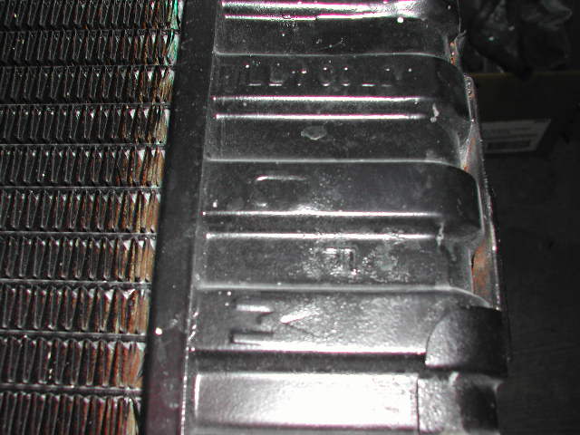

On a 68 big block nova the radiator has a code of CM with a little "F" in the middle on the tank. Anybody have the codes for a nova?

CM Suffix code callout is for radiator part #3012411 for a 1967 Big Passenger Car 396 or 427,non Heavy Duty,first design,non A/C,for a Manual Trans.application.

That's the tank code which would have been stamped next to the application code (which Rick mistakenly assumed you were referring to) on the rad tag. Small letter is the date code. http://www.camaros.org/coolingsystems.shtml
Don't recognize that tank code, but I don't know Novas.

You're right Kurt.
Sorry about that Jeff,I didn't notice you attached a picture of the Tank showing the embossed code.

Do you have the tank codes on the other tank? Or do you still have the tag with all of the codes. I do not have CM listed, but I do not have all of the codes yet. Is this for a Auto trans car?
