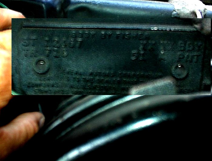

check it out, Pilot? Said the car was in Lakeland Florida for quite a while..Ill post trim tag when he gets it to me...

I think the SN is a little high for a pilot car.I would like to see a pic of the cowl tag XXXX BDY?.

Me too, he is emailing it, ill post when I get it

I think the SN is a little high for a pilot car.I would like to see a pic of the cowl tag XXXX BDY?. [/quote
Agreed,my 69Z is a 10C LOS 505XXX so that would be around an early Dec 68 build..I think they replaced LOS for VN on the trim tag later that month?

Then my car must be a pilot car also, yeah right.
My car was built about 300 cars before. It is an 11B built car and so is this convertible. VN did not show up on the cowl tag until 12C.

i am not saying it is a pilot car, but i thought it was very interesting that it had the xs on the cowl-tag, also i remember that the car was loaded with options.

The pencil rubbing of that tag is in Hoopers Camaro book on page 397.

Sounds also likethat 69Z listed a while back that had ZZ stamped into the cowl tag....remember it was stamped from the back side....i believe its still a mystery of why??

Here are the Tag Pics, There is no build date?
