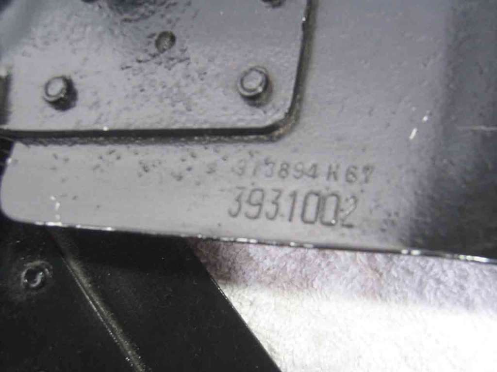

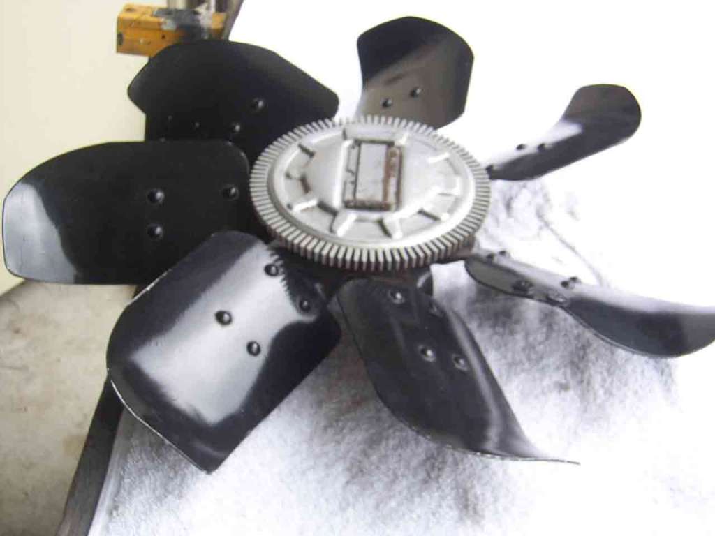

can anyone tell me what application this clutch fan is for
I have had this fan for years and finaly my curiosity got the better of me.
number on the blades are
913894K 67
3931002
L67 RC.?????

It's dated for 1968 & applications are:
Pass.w/A/C 396-427
Chevy II w/A/C 307
Camaro w/A/C w/8CYL,except 396
Chevelle w/A/C w/8CYL & 327 SPCL.Hi Perf

clutch fan pics
Peter

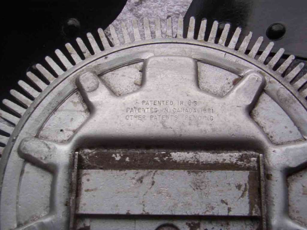

Old 07-17-2005, 11:57 PM
P.J. P.J. is offline
Join Date: May 2004
Location: Ontario Canada
Posts: 1,320
Default Re: clutch fan question
another>
Old 07-17-2005, 11:58 PM
Join Date: May 2004
Posts: 1,320
another
