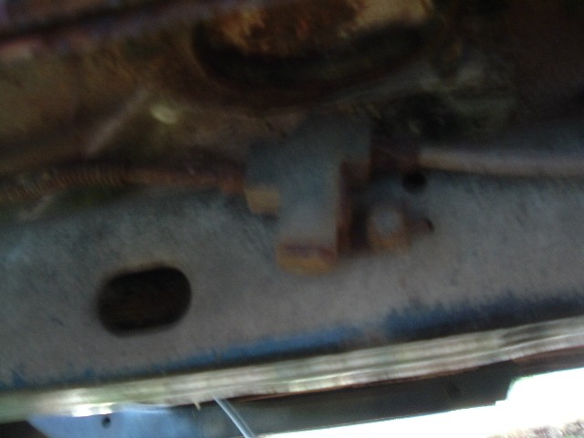

Does anybody have a picture of the break line valve that is located on the frame under the driver's seat for COPO Camaros. I've never gotten a good look at one...these came on SS396 cars as well right? - did these come on SS350 cars as well?

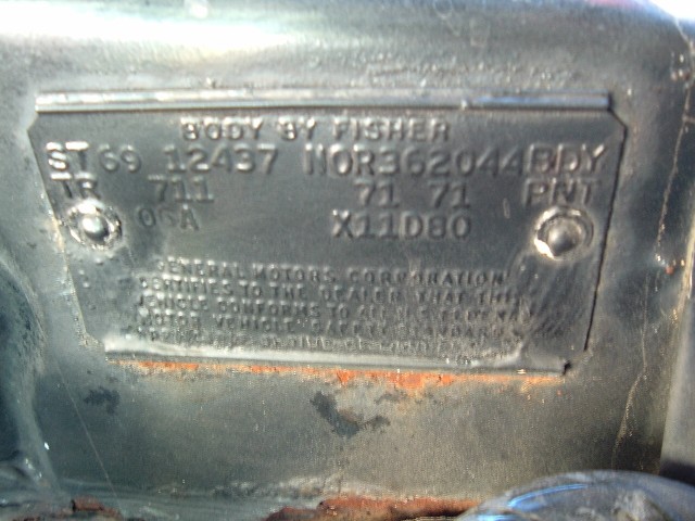

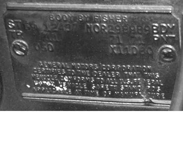

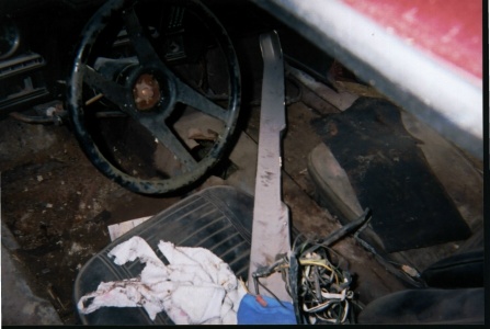

The reason I ask is I'm trying to educate myself on COPO Camaros and I haven't spent much time researching them, instead I've spent the last 4 years of my life concentrating on BM cars...to make a long story short, a friend of mine recently contacted me about a car he had found (he's helping me in finding a car) that may be a COPO Camaro and I need help in getting details and input. The VIN is not on the list of cars Ed Cunneen has on his site, but I have given Ed all the information I can on the car. The car is not located near me so my friend sent 3 digital pics and had computer troubles so he will be sending me some "regular" pics through the mail. Some information on the car that I have gotten. The car is an X11D80 car, build date of 06A, Lemans Blue paint and standard black interior, single fuel line and a 4 speed car. He looked at the rear axle tube with a magnafying glass and said it looked to have a BE rear end but it was hard to see under the car and there are welds close to it as well. I will put up the pics that I got from him and will welcome ALL input and also what else to look for on the car. He said that the radiator is gone, no motor or trans, and the heater box is not there. The first pic is of the trim tag.

Brake valve I inquired about...not a good pic
