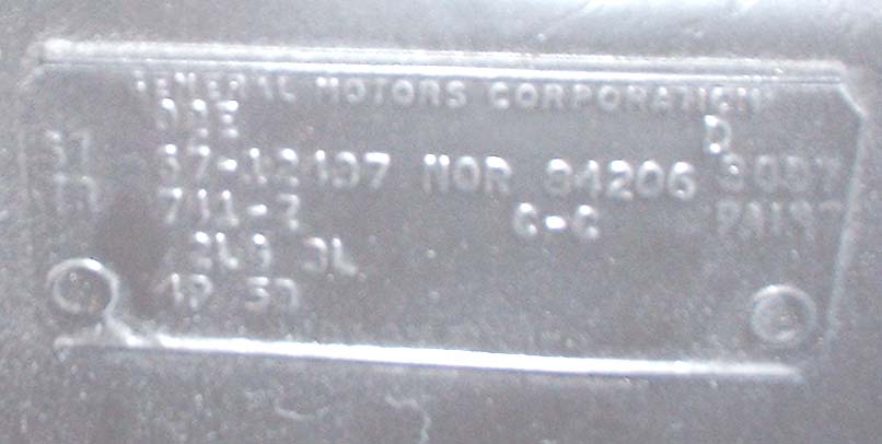

I researched my VIN and trim tag last night for a guy who was interested in a car. The trim tag varifies what you can see on the car, White, Red Standard bucket interior, 4-sp, V8, RS/SS-350, deluxe appearence group. But what I wrote down the VIN it start 12337 which is for a 6-cylinder coupe. What's the deal? I don't see any tampering with either tag.

How about a picture of the cowltag? Vin numbers usually never lie, and yes that is a 6 cylinder VIN.

I do have a picture of it and I will post it later. The only problem with someone faking a trim tag would be that you would have to find an RS/SS-350 trim tag for a white/red 4-sp car, because that is definately what the car was from the factory. Then someone would have to buy all the hide away headlight set-up, put a 12 bolt in the rear etc.

Sounds like you're looking at the body number on the trim tag, not the VIN number on the door. You would need to give us the information from both the VIN tag and the trim tag to determine if it sounds fishy or not. A picture of the trim tag is helpful as well. If the trim tag is held on with screws, that's not a good sign. It could be that somebody swapped the driver's door from another car and it was a 6 cyl car. What is the VIN on the title?

So here is the info;
VIN 123377N138511
Trim tag
02E D
67-12437 NOR 84206 Body
741-Z C-C Paint
2LG 3L
4P 5B
The hidden ID number under the cowl is 7N184434
Are some of these numbers supposed to match?

Email the trim tag picture to me, I'll post it for you Jason.

I see one important thing wrong so far. The last six
digits on the hidden partial Vin# under the cowl, should match the last six digits on the Vin#, located on the post. In this case, they don't. Let's take a look at the cowltag, and go from there.
What's the partial Vin# on the engine?
