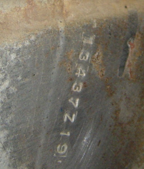

Here is where the question comes in, under the heater box on the firewall there is number stamped on the inside of the firewall that is inside the heater duct area. The number stamped in this area reads 13437Z19. I would expect it to begin with 13637 since it is V8 coupe as opposed to 13437.

I think the stamp you are referring to on the firewall is the part stamp. It would be the same as the base coupe so the part number is the same. The hidden VIN would have the plant code and vin sequence.

Thanks for the reply, can you tell me where to look for the hidden vin that you refer to?
Is the car guaranteed to have a hiddeen vin as you refer to?
Can you tell me what the "Z19" means?

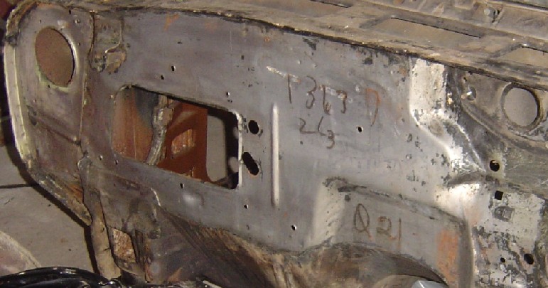

I decided to strip the firewall with a spray can of stripper. The stripper quickly removed all of the black paint to reveal over the tunnel two distinct markings where the metal is more shiny than the surrounding area. It looks like a kid wrote on the firewall directly above the tunnel with a crayon "13637" and "ZL3". Also at the top recess of the tunnel there is also a what appears to have been written "021" I got some photos of this to show the contrast of the metal and the location.
The build sheet does call for the ZL3 conversion.
I could find no stampings on the outside of the firewall except some numbers on the brace that the fender bolts to near the top and it was marked something like 23. The lower brace that includes the front body mount has some numbers stamped on it as well but only a couple digits, maybe 4 or so. I assume these were part numbers for the individual components prior to welding together.
