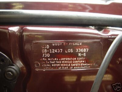

I have never seen a trim tag with a code N - 6. anyone know what is?

Is there a link to the car?
Sam

http://cgi.ebay.com/ebaymotors/ws/eBayIS...p;category=6161

1 = Chevrolet
2 = Camaro
4 = 8-cylinder engine
37 = coupe body
8 = 1968 model year
L = Los Angeles, CA assembly plant (Van Nuys)
334719 = vehicle serial number sequence
Decode for body number: 033687
03D = Built the Fourth week of March.
68-12437 = Coupe.
LOS = Built in Van Nuys California.
730 = Custom Parchment/Black Bucket Seats.
N-6 = Lower Color is Cordovan Maroon and the Vinyl Top Color is White

Thanks it just looked odd to me

N = Cordovan Maroon
6 = White Vinyl Top
Not odd at all and is correct.

I thought 6 was a tan top and thought 1 was a white top.

In 68 2 is for a black vinyl top. 6 is for a white one.
