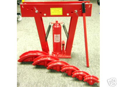

I'd really like to have the abilty to bend my own exhaust pipe or roll bar tubing..etc.. What works? How do all you guys do it?
I bought one of these things and tried it out.....
It was a P.O.S.. All it would do is crunch the pipe. I couldn't make a clean bend with one of these to save my life. So I took it back the next day. So what can I do besides buying pre-bent tubing or going through the hassle to take it to some shop and have it done for me?

Well, Ed, you bought a PIPE bender. It is for thick walled pipe. You want to bend tubing. Tubing is thin walled. The only good way to bend tubing is with a hydraulic tubing bender - like a muffler shop has. They are about $4000.00 or, if you want mandrel bends, about $9000.00.
You can buy various angles in various OD's and weld to straight lengths or you can heat your tubing and bend. You won't like the results of the latter at all.

Yeah... I figured.. I was just hoping there was a cheap manual bender out there that I didn't know about that did a decent job. I guess I'll be buying pre-bent mandrel pieces to hack and weld on...
