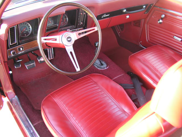

thanks for the feedback. What would the car setup look like if it had a console but no tach? would a clock be where the gas gage is(right side large gas gage)?

Here is tach with center fuel guage and no clock.

With or without a console, you could have the large gas guage on the right and the clock in the center, or just the gas gauge with no clock. The U-16 gauge option consisted of a tach on the right and a gas guage in the center, just like the picture Charley showed you. However, the U-16 guage option was avaiable with or without a console.
The U-17 gauge option would consist of a gas gauge, water temp gauge, oil pressure guage, and the battery amp guage on the console, with the tach on the right and a clock in the center, on the dash, behind the steering wheel. Good luck!
