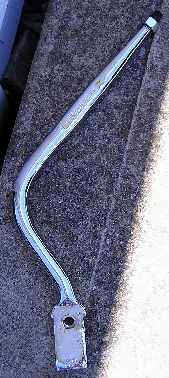

Here is the first detail pic, the infamous GTO/Tempest bench seat Hurst shifter arm that was attached to the '69 Camaro Z28 shifter with small block attaching bracket and big block shifter rods. The '69 Camaro boot/bezel combination was also utilized. The additional boot/bezel that is commonly found will be in another pic.
Hurst arm #4177.

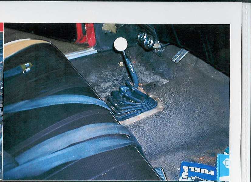

This extra boot/bezel combination has been found on many of the 4speed Deuces. Our research indicates that Yenko installed them, but not consistently. The original GM boot/bezel is always underneath. It appears to be the same combination that was installed on the standard a/t shifter, the Autostick.

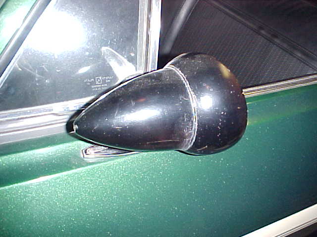

Sport Mirror Option
Marlin

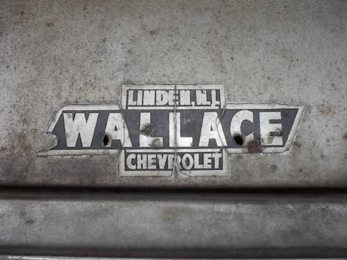

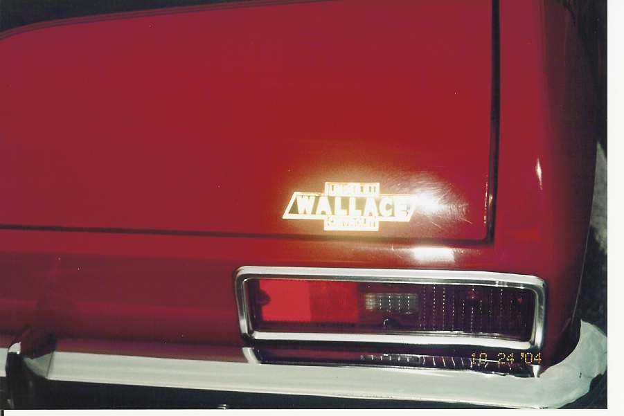

Dealer decal placement for the Wallace Chev. guys.
Marlin
Old 12-04-2004, 12:31 AM
YENKO DEUCE REGISTRY's Avatar
Posts: 13,108
Thanks: 737
Default Re: Yenko Deuce Resto Details
Wallace Decal placement,
Marlin
What about the aftermarket hurst shifter stick shown in the pic? Is it confirmed that Yenko put the hurst super boot over the existing factory boot, or could this just be something that owners did "day 2" style for the full "Hurst look" ? Seems odd that Don would spend an extra nickel to add a second shift boot.

Joe, I think Marlin is just useing that picture as an example of the boot. I'm fairly sure that's a picture of Engler's deuce on arrival here from Fla. That shifter was installed in the 70s by a previous owner. Schonye

I figured that Ken, but I was just wondering why it is believed the big honkin' Hurst SuperBoots were installed over the exisiting factory boot from Yenko... I could see owners doing it, but would think it to be odd for Yenko to do it at Canonsburg before the cars were sold new... did it happen on the PA built cars, or just the Deuces done at Hurst? Maybe Hurst threw them in there at no extra cost to Yenko for a little additional advertising for their products?

Joe that info is new to me on the boots. My sf yellow deuce only has the one boot and it was a Hurst car. Schonye

They are found on cars with the original shifter, and on both PA cars and Hurst cars. We believe Yenko was doing some extra advertising for the Hurst shifter in the Nova. It's a hit or miss thing, inconsistent, but when original owners are contacted, they say it was in the car when they purchased it. Could also be a purchasing dealer install, but unlikely, they usually went with the trim rings, bumper guards, etc... dressy items.
