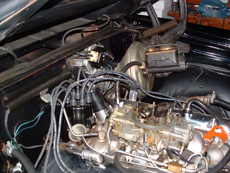

I hate wiring ! Can someone give me an idea where the TCS lead breaks out of the main harness and heads for the front of the intake manifold? Now that I’ve got all these parts reinstalled, the same ones that 35 years ago we immediately removed upon purchase, I’d like to be able to plug it in and make it work.

Scott,
See if these pix answer your question.
Dennis

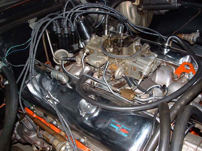

Default Re: 70 Chevelle TCS Harness
Another view
