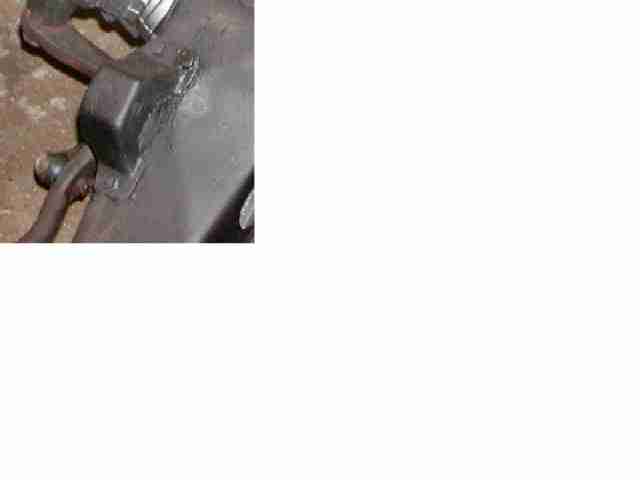

I'm not sure if this is what you were looking for, but this is a detail from my car when the motor was out of it last year. Hope this might help.

Sorry Andy, my fault for trying to be a better linguist.
I'm referring to the rubber motor mounts, not the frame
mounts.
Does that make more sense?

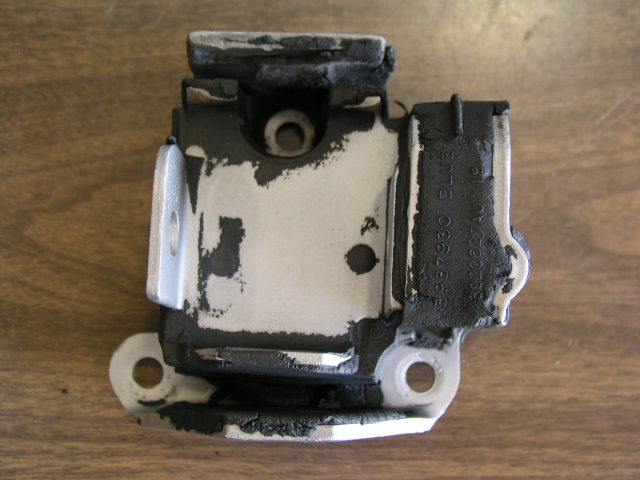

Here you go.

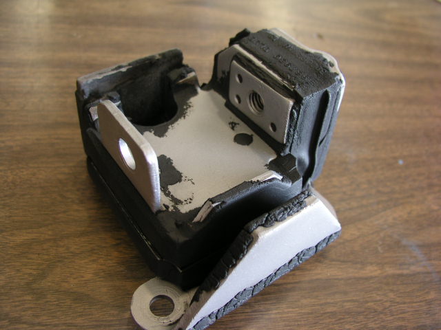

another view

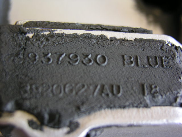

Part #

Charley,
The pictures are absolutely awesome!
Exactly what I needed to see. Now, do you happen to have
the correct long bolt, whasers, etc. that you can post a
picture of? Again, this will enable me to identify the
correct parts when I find them.
