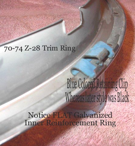

I'm trying to install 4 brand new GM SS trim rings on my 14X7 original SS wheels. They are very tight and I can't get them to go on so far....I don't want to dent them by slamming them on with something. Is there an easy way to get these things on?

They are a pain. I position them on the wheel and try to lay my forearm (with pressure) from side to side and gently bang them down with a rubber mallot and a towl over the stainless. I just slowly work my way around several times till they fit. Don't get MAD either!!! [img]/ubbthreads/images/graemlins/headbang.gif[/img] Sam

They are hard. Try using a rubber mallet. You do have to strike them a bit to install completely.

You have gotten good advice so far, when and if you use a rubber mallot (I usually use my palm) try putting a block of wood covered in a towel layed out flat on the edge of the ring and hit the wood so this will spread the force of the blow out to lessen the chance of denting it.

Let some air out of the tire. Deflate them down to around 15 psi or so. Then use the palm of your hand.

Yep, I remeasured to make sure they were right. I'm going to try the wood and towel method with a rubber maller and an extra pair of hands today. I'm also going to put a little soap on the inside of the tabs to see if they will slide a bit easier. Intereting enough, one of the wheels has this code on it: M4 5 10 LZ and I have no idea what that code it (the other 3 are YA coded). What the heck is LZ????
