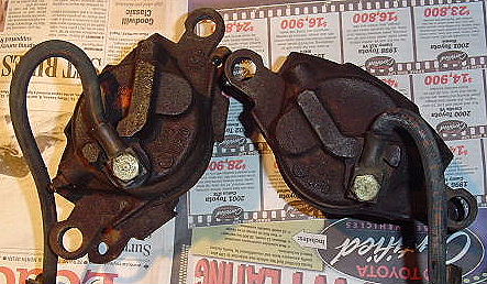

Were brake calipers date coded?
I took apart front disk brake/A-arm assemblies from a supposed '69 Z28 wrecked in 1970. Yeah, I thought that too till I saw them.
These are "virgin" calipers that have never been rebuilt & the rotors are thick enough to look like they've never been turned.
There is a single number '9' cast into each caliper that looks like it could be a date code?
The single number '9' is made in the casting by what looks like a replaceable die (you can see a slotted screw impression) just like a date code would be.
I have seen Julian date codes & it's not like that, it's cast not stamped. It's more like what would be on a water pump without the Month letter & day number just a '9' on the end (blank, blank, 9).
It could be a 6?
I heard that 69 calipers are supposed to be "V back".
I don't know what other years had that shape on them. Most GM calipers look similar except the hose location is in different places.
These calipers have that "V back" 2 "v" notches in a rectangular bar that keeps the brake line's square brass block from rotating.
GM dated coded most of the cast components so wouldn’t this make sense?
How about you guys with judging know how , would this "date" count for points?
They also have the number 22 stamped into each of them on the bottom edges.
Are there tons of these around?
I could post a pic if anyone's interested but I don’t have the software to resize it, or maybe I’ll just link a picture later.

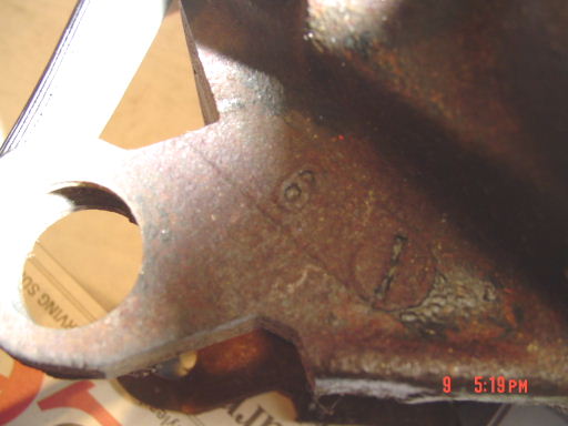

I believe they are dated, and can look later in the day and see if I can explain what I have found on various 68's

I found some dates stamped into my JL8 calipers. Some of them had "C" and a number and I can't remember what the others had. But my calipers are the 4 piston style, not the single so I'm not sure if they stamped them. Check along all the flat areas closely. Hold a light at an angle and you might be able to see faint impressions.

It took me awhile.
My 68 calipers had a julian date on 3 of 4 halfs. 3 had 138 & the last was 141
Do these look like a date?
