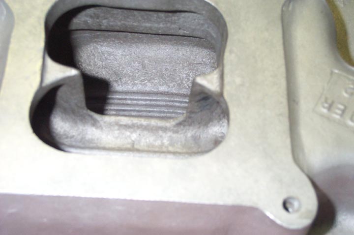

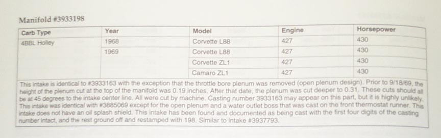

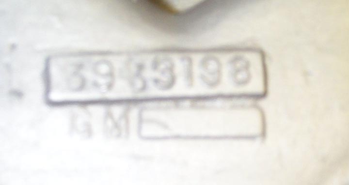

not sure what this intake came on? but it's very similar to the 1969 version but the funny thing is the 3933198 numbers look to be altered eg. the first and third digits #3 are ground down and restamped 3+3++++ and the plenum has been cut down, looks like a nice job but 1973 date code has got me baffled. I read that this intake was made for 68-69 zl1 427 L88 430hp camaro and vet. The guy that traded me this intake told me it came off a LS7. Any body ever see this intake with numbers ground and restamped? I thought 163 intakes came on LS6 and LS7 crate motors?

plenum

3933198 pt # (poor pic)
