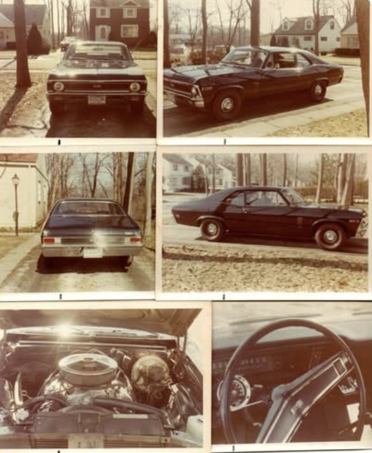

I'm not a Nova expert but, if I were to spend that kind of money on a car I would want the body panels, grille and bumpers to line up waaaaay better than what I see on this car.
I can't speak to the COPO claim but, I am sure the more knowledgeable folks on this site will enlighten us.

I stopped looking when I saw the brake booster.
Yea, I got that
So does this mean the front engine hook was installed after the engine was painted.........I am sorry had to do it

Originally Posted by m22mike View Post
Yea, I got that
How about those french locks on the exhaust manifolds...must have been a mid-year option

I think Stevie Wonder and Ray Charles did the panel alignment on this car. Ouch !!!

Nice tattoo's...
As for the car...well
