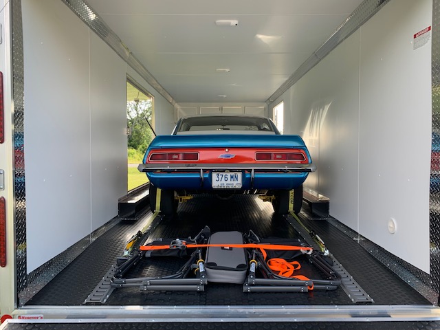

Does anyone have experience installing ETRACK in their Wood Floor trailer
and using Over The Tire Strapping / Baskets to anchor their car during
transport..............
My ETrack wont be centered on my tire center..............
I'd like to SEE pictures and ask questions................

I have ETrack that came installed on my enclosed trailer. Wood floor with heavy rubber mat permanently installed. So, I’m not much help on the installation process. The tracks are installed to be centered on first gen wheel base, but I’ve used it to transport larger wheel base cars where the tires aren’t centered & it worked fine. To be honest, I don’t use the ETrack system when I’m trailering a car short distances. It’s a PITA due to the limited room between the car & the wall of the trailer. The system really comes in handy for tieing down multiple side-by-sides.
Overall (for me), it would be used a lot more on an open trailer, but I’ll get it on my next enclosed trailer just for its versatility in securing other stuff.

I have Etrack installed in an 8.5 x 24 enclosed CarMate trailer. Plywood floor with permanent rubber coin mat. Track is installed to match track width on 1st gen Camaro. Etrack is installed with 2 1/2" long self-tapping lag screws. Most of the screws just go through the plywood, but you want to make sure some of the screws catch your trailer frame crossmembers for some really solid holding strength.
I love the system though accessing the sides is a little tight, it is better than laying on your back to wrap the axle and front end. I also added front wheel chocks and mput a mark on the leading edge of the trailer ramp that lines up with the track on the drivers side. Once you figure out where your car needs to be to get proper tongue weight, install the chocks and loading becomes a breeze. Just line up to the mark on the ramp and drive in until you hit the chock.

R68GTO, I chose to align the outside edge of E Track with Outside Edge of I-Beam
Trailer frame , so ALL the Outside Etrack holes/fasteners are going thru metal......Inside edge
of Etrack I used Stainless Button Head Allen Bolts all the way thru Plywood Floor
with Double Fender Washers and Nylock Nuts...........
I have not yet loaded a car but I already know that center of E Track wont be lined up
with Center of Tire..........It will either work similar to yours, or I may buy the basket type of strap that goes around top of tire...........
Im thinking it may be difficult to lay down and fasten E Track Strap at Rear of Front Tire..
So Far Ive only installed front E Track , before I committ to all the time and buying fasteners for Rear E Track.........
I move 70 Camaros and C6 Corvette Wide Body..................
