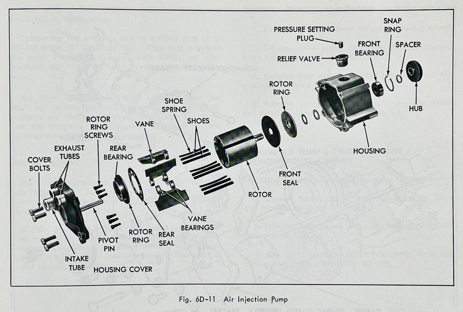

The first item in order, I felt I could get the car to run better. While it ran good, the engine seemed nervous. I did some testing of the A.I.R. components, and found one of the check valves and the mixture control solenoid were not quite up to snuff. Added to that, these cars always respond well to a fresh set of wires.
