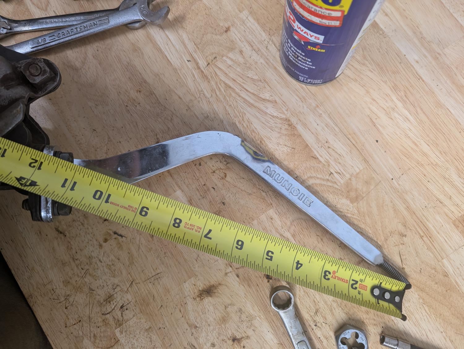

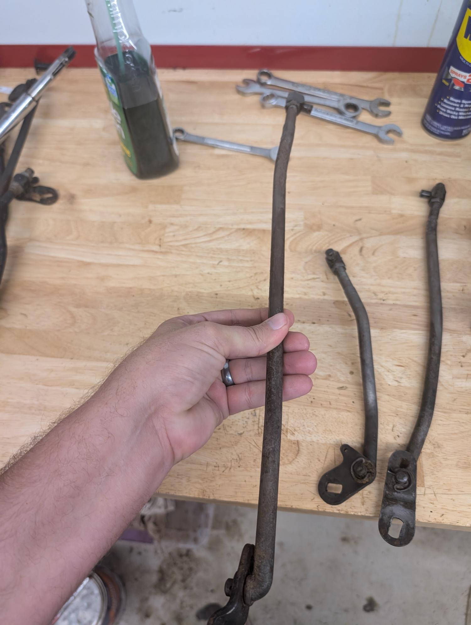

Was hoping to get a perspective from you all on a shifter I have. This particular shifter is out of my depth, but based on the rods, linkage, etc I am thinking it might be 68 Impala. It has an orange dust cap that covers the reverse resistance bearing.
I don't see any numbers stamped into the rods or the shifter handle for that matter
Any help/information on it's correct application would be appreciated.

Here’s a photo of Muncie shift levers and dimensions.
Maybe that will help you in identifying the shifter, Rob.

If I'm looking at it the right way I think mine is 68-69 Impala Bench shifter.
