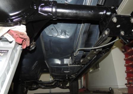

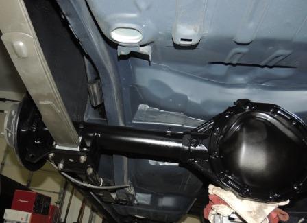

Worked on the undercarriage. Turns out there really is a right and left of the shock plates. Had to swap them. Finally, took some pics.
Fuel line in place (missing little clip at the back end). Went with stainless. I know it isn't original, but a worthy update. No rust. Going with stainless brake lines as well. Consider that a safety issue.
Plan to pull all the retainer clips off and detail them.
Park brake cables front and rear. My undercarriage was painted light gray in the back and got darker just ahead of the rear axle. So that is what I replicated. Color is pretty darn close. Man, it is getting dusty under there. You can even see some of my hand prints. Need to clean up the cob webs.

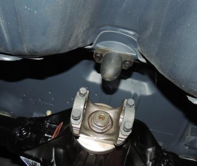

Took one shot showing the date code stamped in the floor pan, right rear.
Kind of cold out in the garage. Sherri and I are planning to build a workshop as soon as this thing is road worthy. Think I need a radiant heat floor. Hmm.... maybe should have built the workshop first. Sure am making a mess in the garage.
You can tell I don't know squat about photography. Just point the Nikon and hope it is smarter than me.

In the meantime, got my fuel and brake lines all installed and clipped in place. Also got the two clips riveted to the subframe for the pos batt cable. I fubarred one of my rivets, so had to find hollow rivets. Hmm... seems none of the hardware stores carry them any more; at least not around here. But... hobby lobby has a bag of 100 for less than 2 bucks. Fubar away. Made a little tool to &quot;set&quot; the rivets and it worked great. Also dipped the top half in plasti dip to rubber coat them as originals.
Haven't seen this in print anywhere, but my original fuel line had a dark green paint stripe ID on it. So I put one on my new stainless line. Probably pretty silly for a car that will get driven, but hey, it took all of 2 minutes.
