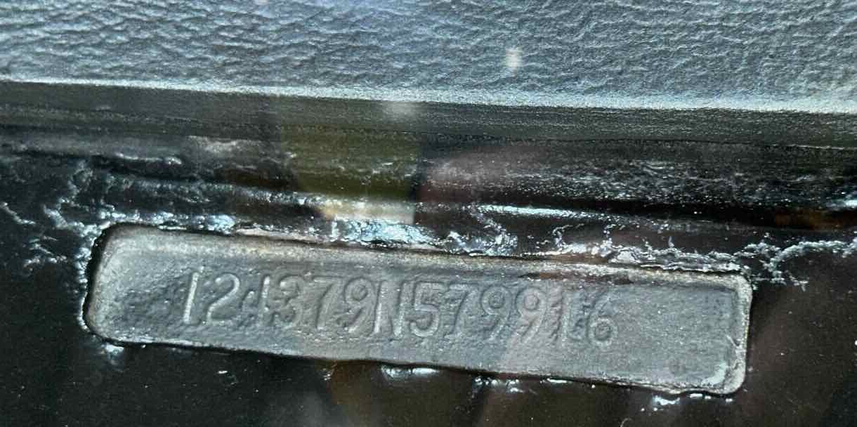

https://www.ebay.com/itm/226667219157
124379N579916
From the ad: 1969 Chevrolet Camaro REAL X22 SS
The error makes this one easy.

I hate it when people put Z28 stripes on a SS, with the exception of Z10 and Z11. And they didn't paint the grill!

Tag photos.
You look at the trunk floor install and home made left side shock mount, the gobbed up dash panel and open seam, sagging headliner and it's just a pig with lipstick anyway...

Sledge hammered dash vin area and fresh tag kind of makes you wonder what is going on

Wow! A mess.

"... just a pig with lipstick anyway..."
I am going out on a limb here and say that this car would have to be greatly improved jus to get to "lipstick on a pic" status.
Can't imagin all the hidden rust on this "gem".
