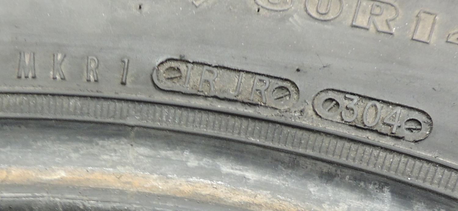

235 60 R15 tire
I am GUESSING it is OLDER than 2000.
Has an eleven digit code. On tires since 2000, the last four are the date code.
These tires only have 3 digits in the last spot.
Can anyone tell me the dates of these tires?
Attachments - The Supercar Registry IMG_0015.jpeg IMG_0014.jpg Goodyear.3.jpg Goodyear.2.jpg

Think I just answered my own question.
304 would be 30th week of 1995 or 1985 or 1975.
Minimum 30 years old. Guess I won't be driving on these!!!!

Bruce;
Looks like a three digit code, meaning before 2000.
I would say 8th week of 93, or 83 or 73.
Source: https://www.goodyear.com/en_US/learn...date-code.html
From that article: If your tires were made before the year 2000, the date code will be only 3 digits – the first two digits again listing the week of the year, and the last digit being the last digit of the year of the tire’s manufacture. This means a date code of “529” could mean the tire was manufactured in December 1999, or December 1989 – or even December 1979.
